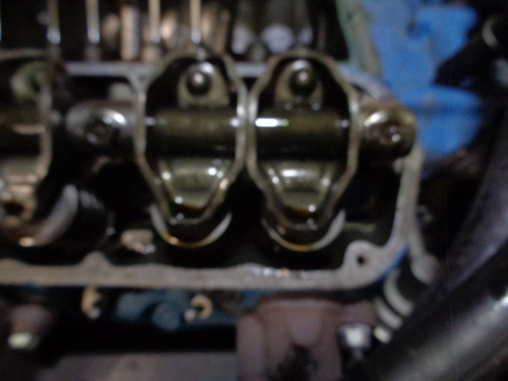

Michel's 1970 Polara convertible arrived today fresh off the transporter from Wash. DC. First on the list of repairs was to find the cause of a sever engine miss. I ran a vac. gauge plugged into the power brake booster nipple. The vac gauge needle had a fluctuation of about 5" of vacuum between 10" & 16" of vac. Compression test confirmed no compression on cylinder 1. All other cylinders were found to be good.
As you can see in the photos below w/ the valve cover removed the push rod for cyl 1 intake valve has pushed through the rocker arm. Closer inspection revealed that there was wear on the push rod tip. What I didn't expect was the push rod was still straight. The heat-treated tip of the push rod worn away rendering it unusable. There were no indications of poor lubrication or plugged oil feed holes. Also note the odd wear pattern on the exhaust on cyl. 1 and on the corresponding rocker arm for that cyl. Clearly misaligned rocker arm to valve present. That will necessitate cyl. head removal. Note the metal pasty sludge in the intake runner for cyl. 1. Defiantly this sludge paste is the result and caused by the failing rocker arm. Will be removing both heads for inspection and to any contaminated oil in the lifter valley. This pair of cyl. heads should have held up better considering the low miles on them. More updates to follow.

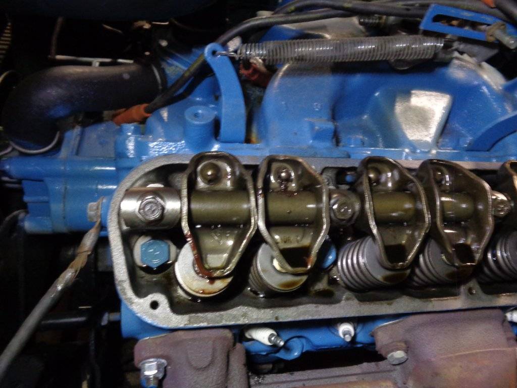

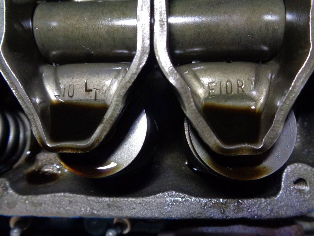

Here is an update to my post from yesterday. I removed the intake manifold and right valve cover to further inspect for oil contamination and or any other abnormalities. What was found is conclusive and the cause of the rocker arm failure. After removing the right valve cover the next two photos show the right rocker arms having the same misalignment as was found yesterday. Note the rocker shaft washers. There width is noticeably greater on each end of rocker shaft. note the position of the rocker arms to the valve stems. @rags noted this yesterday. This is the cause of the misalignment. The washers push the rockers off center. The large washers were mis installed during previous cyl head work as proven by today's discovery on the passenger side cyl head. Switching the washers to their proper locations corrected the rocker arm misalignment. Unlike yesterday no rocker or valve stem damage was found.
shameful that such a thing should happen. a problem that is naked eye visible not detected on a final inspection before assembly. mistakes happen but this is why we check, double check... everything.
For sure. I'm flabbergasted about this obvious mistake. I was 16 (~1973) when I rebuilt the 273 in my grandfather's 65 Dart GT, and young stupid inexperienced ME knew the reason for the proper placement of those spacers. Geeeze.....
I am a little curious about the blue headbolts.....must be made of tantaldelanium or something!
The top of the head bolts appears to be powder coated. I share in @Trace 300 Hurst and @rags disbelieve that a simple assembly blunder of this magnitude took place. I always take notice of component relationship and condition on tear down. Considering the cleanliness of the found I too was blown away by the mistake found. @Trace 300 Hurst for your viewing pleasure one very bloated muffler.
