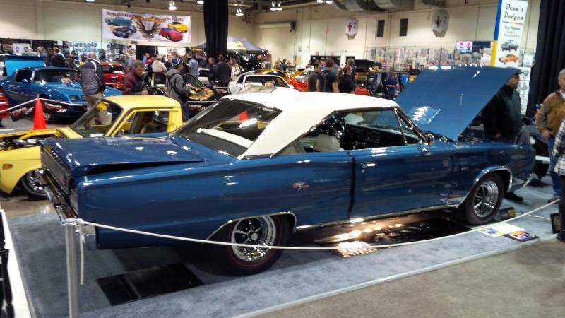

Here are the specs:
R/T Quick Specs Short-block Ray Barton 493 built 70 440, {{{Eagle}}} crank 4340-steel forging 4.15 stroke, JE flat-top pistons, Manley/Barton H-beam rods Camshaft Lunati VooDoo roller, 255/263 duration at .050-inch lift, .600-inch lift Valvetrain Comp roller lifters, Hi-Tech 3/8-inch pushrods, Pro {{{Magnum}}} roller rockers, dual valvesprings, Titanium retainers Heads Edelbrock Performer RPM, 2.14/1.81 valves, ported, flow 293/227 cfm at .600-inch lift. Induction MP M1 single plane, polished plenum, dividers, runners, except floor left as-cast, no gasket matching. Wilson Manifolds 1-inch, 4-hole tapered spacer (PN 004110). Holley 950HP, 78 jets, 40 squirters. Exhaust 2-inch tti headers, 3-inch tti exhaust with DynoMax Ultra Flo mufflers. Drivetrain Pro-Formance-built 727 with rollerized planetary, Hemi governor for auto upshifts at 6,{{{200}}} rpm, Dynamic 9.5-inch converter. Denny's 4-inch HD aluminum driveshaft. Randy's Ring and Pinion-built 83/4 w/3.55s and Detroit Locker, {{{Yukon}}} axles. Suspension FFI and Magnum Force front-end components, Stock leaf springs re-arched with 1 leaf added per side, QA1 shocks. Ray Barton Wedge develop 660 lb/ft of torque at 4,100 rpm, and 621 hp at 5,600 rpm at the flywheel.
Aaaarrrfff !!
