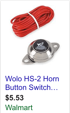

Thanks for asking that question. I just took my rim blow off today and made a few calls to find out the price to restore. This will be good info to know if there is a wheel that could be swapped in lieu of a rim blow.
You should be . If I lived where you lived ( working on it) I wouldn't be using my horn much if at all either ...:thumbsup:
