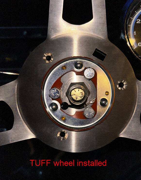

Hello, I have a '71 Chrysler 300 that was originally equipped with a tilt and telescope steering wheel and rim blow steering wheel. The original steering wheel needs restoration so I got a Grant TUFF reproduction steering wheel to use.

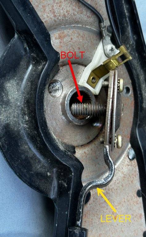

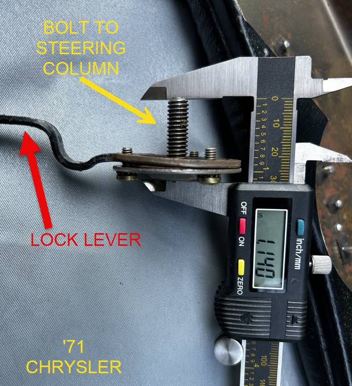

The TUFF wheel mounts fine, except that the steering wheel is not locked to the column so it can travel up and down while you are driving. This proves to be a bit distracting. I looked at the parts I have from the original wheel to try to see if there was a way I can just lock the wheel in place. There is one bolt in the center of the steering wheel, and I did put a bolt there, but it had no effect on locking the wheel - so I am wondering if I am missing a part somewhere.
Here are some photos of the original wheel and mechanism, I was hoping someone might be able to tell me what part I may be missing, or what the trick is to lock the wheel in place without the adjustment level.

Yes, it fits well and, I think, looks good. I have seen some comments that it is best to use a reproduction horn ring (the part with the contacts ) rather than the grant one which is in my photos and is rather flimsy. I have not tried the horn function yet, as I discovered my car has the horns disconnected at the moment and I want to get the wheel fixed first. The way the lock on the telescope function seems to work, as far as I can tell, is that moving the lever cams the center bolt up and down, so if I am very lucky, the solution may be as simple as finding the correct length bolt and tightening, maybe adding washers to pull up whatever the bolt screws into. Finding a schematic of the device would be helpful.
