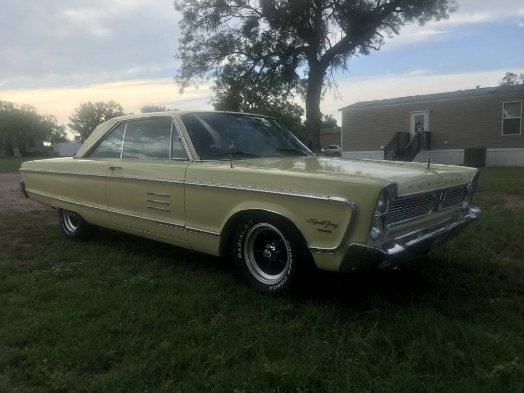

You can easily run a 15x7 rim with P255-60R15 tires all the way around. I did that with 15x7 cop rims on my 65 Sport Fury. I had no issues with rubbing, front or back. You can go with 15x8 and 275-60R15 on the rear (265 if you have skirts). bigger than 255 on the front might work but I never tried them there.
Thanks
275/60-15 rear on 8" wheel 4 1/2" BS
225/70-15 front on 7" wheel 4" or 3.75" BS if you can find it.
Front and rear are very close to the same 28" diameter
