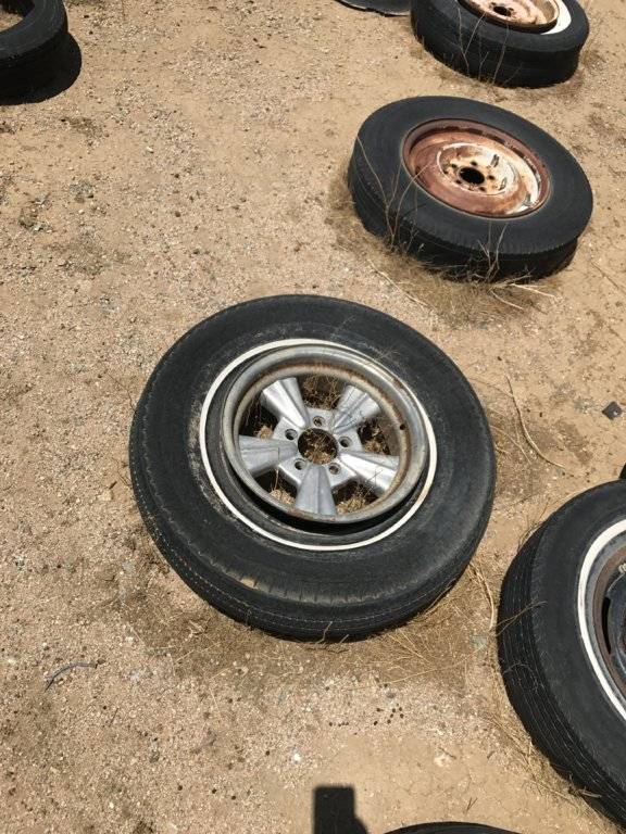

The common item between Ford and Mopar wheels is the bolt circle and number of wheel studs. You'll need to look for Mopars which still have FRONT WHEEL BEARINGS, not an assembled bearing hub, which means the wheel's surface where the lug nuts tighten against is much closer to the outside edge of the wheel rim. The earlier "wheel bearing" cars have that part of the rim much more centered between the edges of the wheel. So that's going to mean, mostly, a 1981 and prior Chrysler Corp car. The later rwd Fifth Avenues (and siblings on that platform) would still be "wheel bearing" cars, too. This also means the disc brake rotor and the front hub are one piece, too. No detachable brake rotors as the wheel bearing hub remains on the vehicle.
As noted above, the center "register" hole diameter in the middle of the wheel is important, too.Just as wheel stud diameter is. Get a 3.5x5" note card and make a measuring template for the distance between the stud holes and also note the center register inside diameter on it, too. That should ensure you get a Mopar-spec wheel. IF you happen to find a Chrysler wheel in a pile of loose wheels, on the inside center recessed part of the wheel rim, the wheel size should be stamped in that area. Could have a Pentastar stamping, too, as there should be near the valve stem area, too? That ID plus your template and the more-centered backspacing of the stock wheel should help get home with something that will work.
