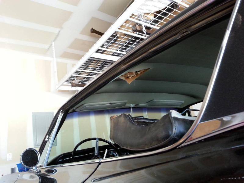

I'm sorry to report that last weekend I stupidly punched a hole in my car's otherwise good headliner. I was taking out the rear seat back, going from one side to the other to gradually ease it up, and suddenly it popped up into the headliner and tore about a 8-10" hole in it. What can you use to repair this rubbery mesh fabric? This is not going to be a show car; I don't mind if the repair is visible. What would you do???

I'd get some "iron on" adhesive and find a similar cloth and iron on a patch.
It'll look like crap and annoy you enough to get a new head liner eventually. At least it's better than the rip.

You could glue some cloth to the inside of the headliner using spray adhesive and wait for it to dry then glue the flap in place using the same method, you will see the tear still but it will all be back in place.
That's a good idea. Thanks

Old material doesn't stretch very well and good chances are that it'll rip when installing it. I'd either patch up what you got or get a new one installed.They are usually about $200-250 and will take about a day to install.
i had a 68 Road Runner once that someone took a needle and thread and sewed up. Similar location to that rip never noticed it though unless I was cleaning the car.
I'd replace it though and it's probably dry rotted to rip, and rip that much from what you describe
