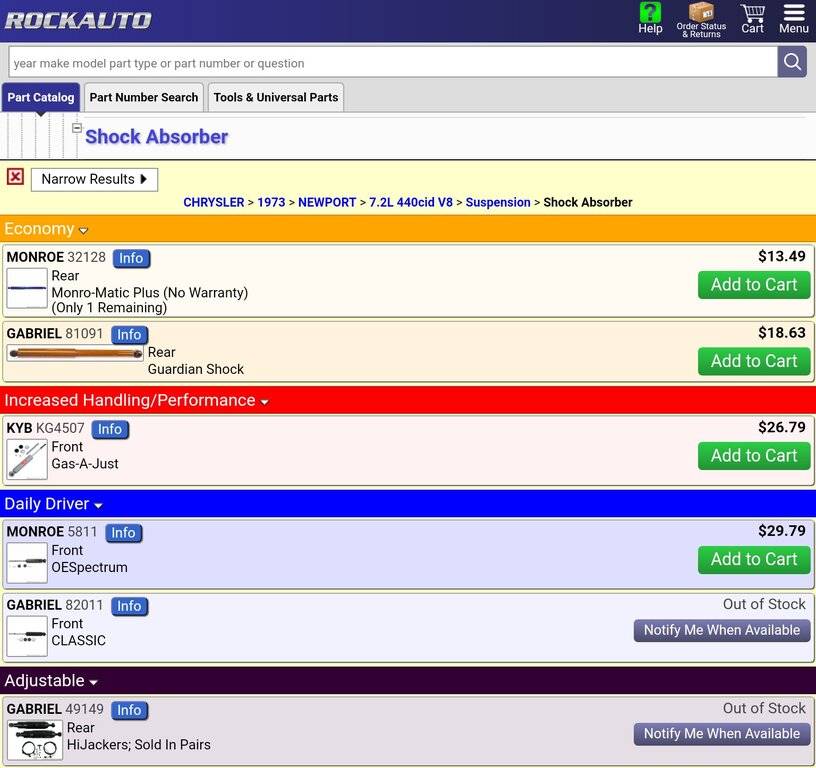

Isn't there a Monroe Sensatrac in the right dimensions? The Sensatrac has a groove in the middle of the cylinder that allows for greater oil flow in the more-or-less center position, resulting in a smoother ride on good roads. When the road gets bumpy or the car leans and the shock piston moves towards either end past said groove the shock gets tighter resulting in a firmer ride under those conditions.
I don't know about the Monroe Sensatracs. In my searches, I didn't see them listed. In fact, there seems to be a general dearth of available shocks for the rear of '73 Chryslers. I like the KYBs that are installed on my '66 300 coupe so much, that I really wanted KYBs for the '73. We'll see what the Shocks Surplus guys have to say. Basically, I need a shock that is at least 25 inches long - extended.
WOW. Talk about slim pickings... :wideyed:
The Gabriels are 25.14".
The Monaco has HD Monroes all around which work fine for my tastes.
But in the past I’ve liked the Gabriel HD Adjustable shocks on our Mopars.
I set the front to to firm to control lean in the turns and normal setting in the rear so car doesn’t want to hop at every expansion joint in the pavement. They weren’t cheap but did make my old Cordoba handle like my Uncle’s Chevys with the F41 handling pkg.

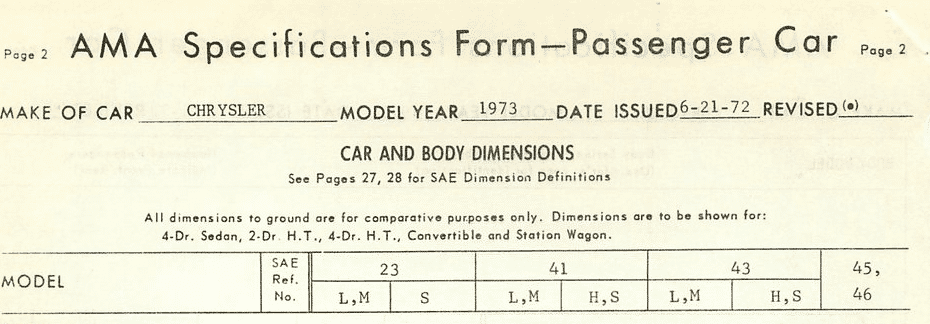

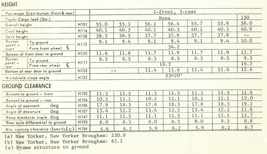

I just wonder whether a 1973 Chrysler will sit higher than a 1969 to 1972 model, perhaps due to bring the bumper to the height required by the new bumper standards, thereby requiring longer shock absorbers in the rear?
Interesting guess. Looking at the Dealership Data Books on the Hamtramck Registry, we see that the overall height on 2dr Chryslers was supposedly up, from 54.8” regardless of model in 1972 to 55” (Newport 2dr) or to 55.3” (NYer 2dr) in 1973.
Then again, @73Coupe had no issue with KYB 5512s on his ‘73 NYB. So, I went looking again and investigated a bit further in the hope of finding the AMA Specification Reports for both years.
The Hamtramck Registry has a copy of the 1973 AMA Specifications, and the relevant page is here. While the Registry does not have a scan of the 1972 AMA Spec report to compare it to, I found a copy for the Imperial at the Hathi Trust Library here but not for Newports or NYers. The AMA report confirms the figures for overall height -- what would be really nice to have are the rear ground clearances.

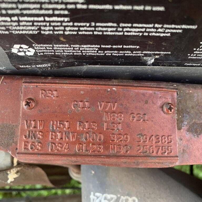

@Ripinator -- I don't know where you see the tips on your tag. Here is the decode:
CL: Chrysler Newport
23: 2 Door Hardtop
M: 400 cid V8
3: 1973 Model Year
C: Jefferson Avenue, MI, USA
317117: Sequence number
E63: 400 cid V8
D34: Automatic Transmission
JK3: Navajo Orange Exterior Color
B1KW: Trim - White Vinyl/Burnt Orange Navajo Cloth Interior
000: Full Door Panels
703: Build Date: July 03
200521: Order number
V1W: Full Vinyl Top, White
H51: Air Conditioning with Heater
R13: Deluxe AM Radio (5 1/2 Watts)
L31: Hood/Fender Mounted Turn Signals
N88: Auto Speed Control
G11: Tinted Glass (all)
V7V: Accent Stripes, Orange
Do you have the build sheet?
In related matters, your build date is July 3 -- the last Navajo tag I have seen. Here is the fender tag of CL23M3C256755, a car that I looked at seriously in June of this year -- the SPD is March 29:
