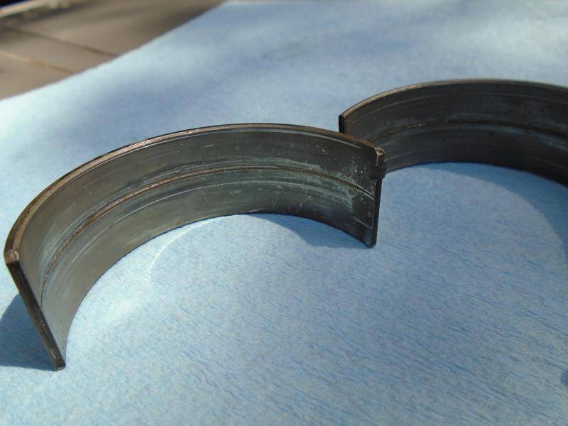

Looks like debris and or too tight. What does the next door neighbor look like, if it is okay it is most likely the rod sized too small. I would emory plastigage just to check and put it back together till winter, like you said. My Challenger has a bad rear face on the thrust bearing been that way for over 12,000 mi. I'm going to fix it someday lol.

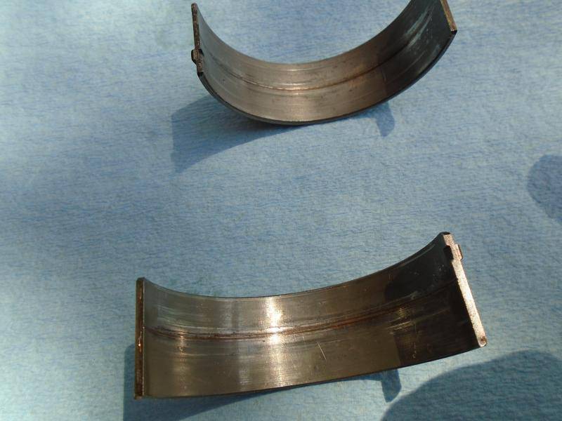

Now you gotta wonder whether the crank will destroy them again, or another set. Looks like a lack of lubrication to me that caused this.
I'm never putting any new forged pieces or cast aluminum anything in or on my engines except Pistons. Give me oem or give me death!
I can't say its totally the fault of the crank manufactor. I built the car up to be a hotrod and did my fair share of thrashing on it. In the end its all a matter of trading off reliability for performance.

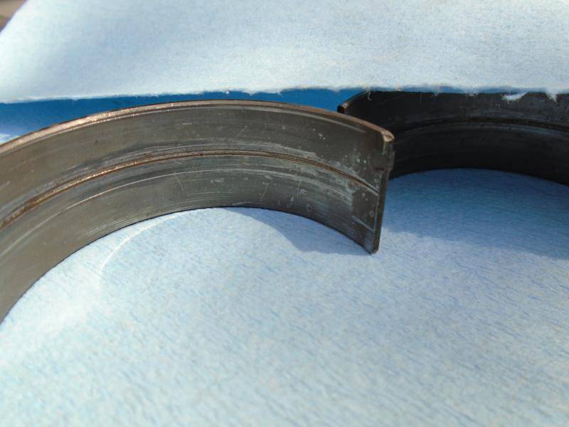

It looks to me like a metal shaving or a piece of debri did the damage. All the other bearings don't look too bad.
Lack of lube would have discolored everything before it seized and spun in the rod big end. Its a clearance or out of round issue. Only reason I say debris is the groove, the groove is in the crank so it will not eat into the new bearing. Wear should be on top and bottom not out by the rod bolts, which leads me to believe too much crush from big end of connecting rod.
My next door neighbor weighs about 300 lbs and she likes to walk around in spandex. The other rod bearing that shares the same journal as the bearing in the photo looks to be in pretty good shape
