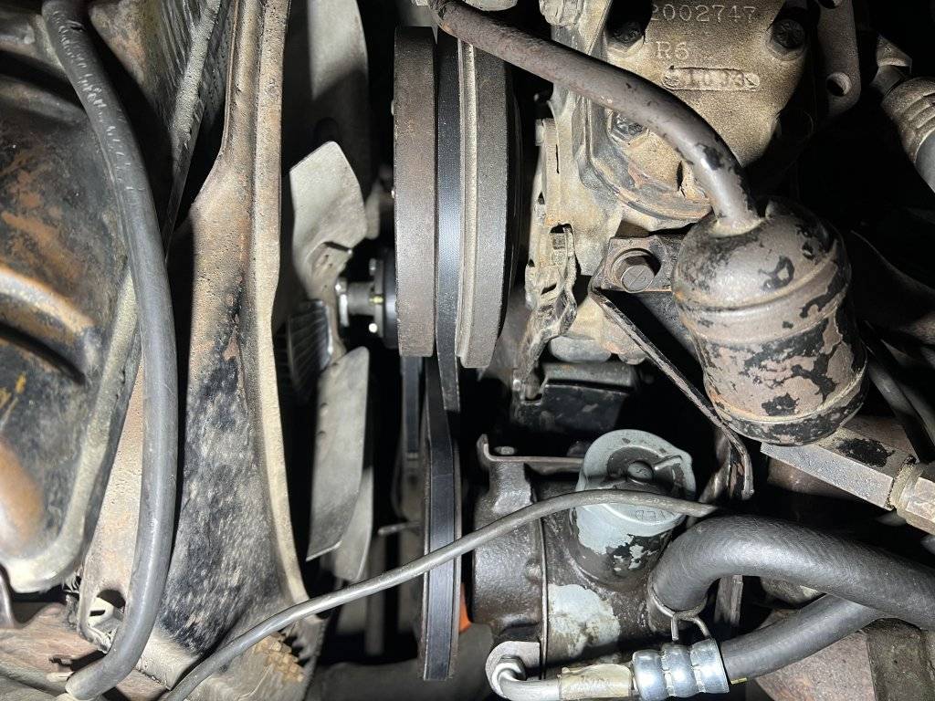

I was working on putting all my belts back on my 413 and the a/c and alternator belt seems to be rubbing against the power steering belt. Along with this, the a/c and alternator pulleys are not aligned at all. Do I have the wrong parts or is it something else?

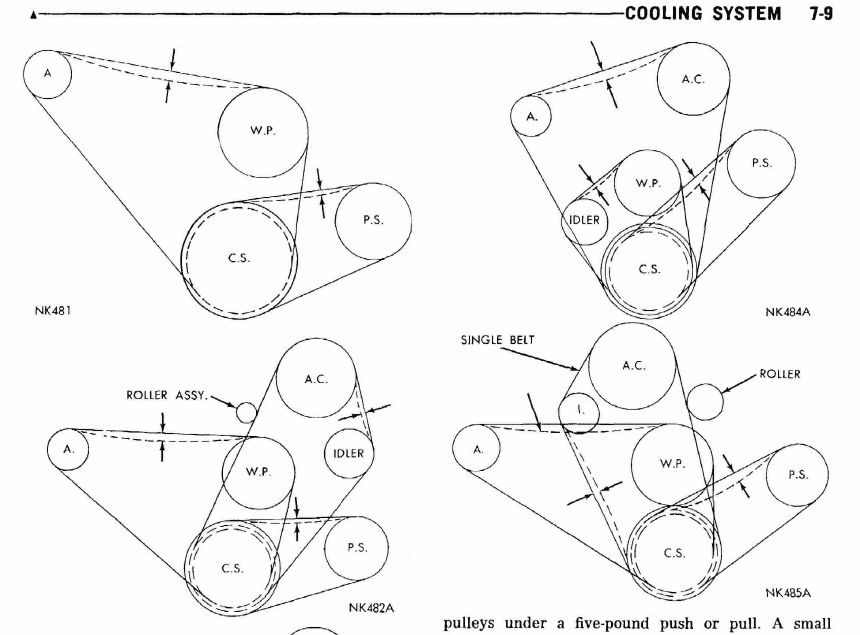

Wondering if the a/c pulley is wrong. Every picture I have seen so far has a double pulley, and double belts to the a/c and alternator. I see the alternator does have the double pulley.
Now don't take my word for gospel, it's just based on looking at pics on the net.
Somebody who knows for sure will be along shortly, I'm sure.
