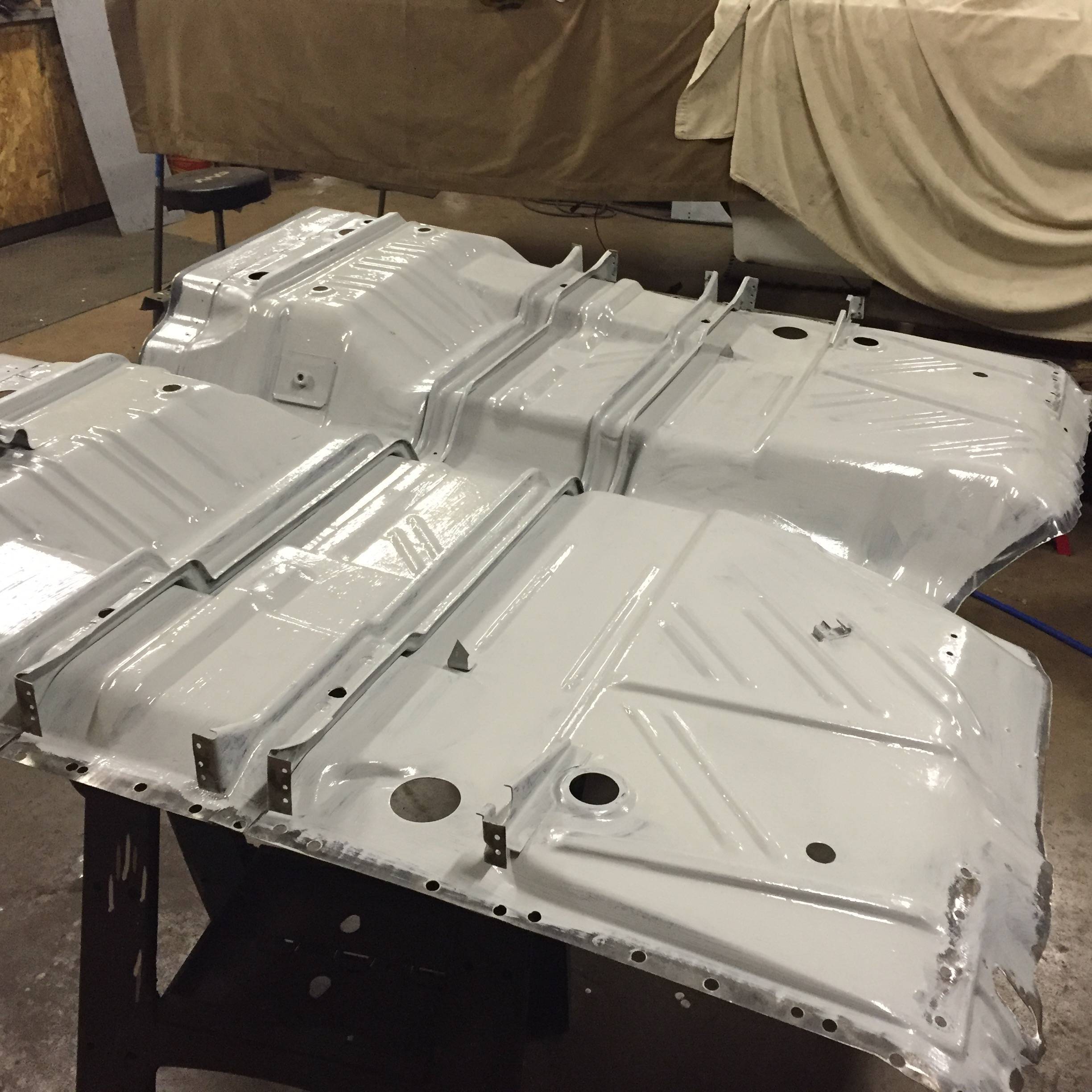

No this is the real deal from a 65 Plymouth fury from Arizona. It had a bit of surface rust which I dealt with. I regrettably cut off the front of the pan since I didn't want to disassemble the front clip off the car again. One day if I do a complete resto I can replace that part since I used a cut off wheel to cleanly remove the front section

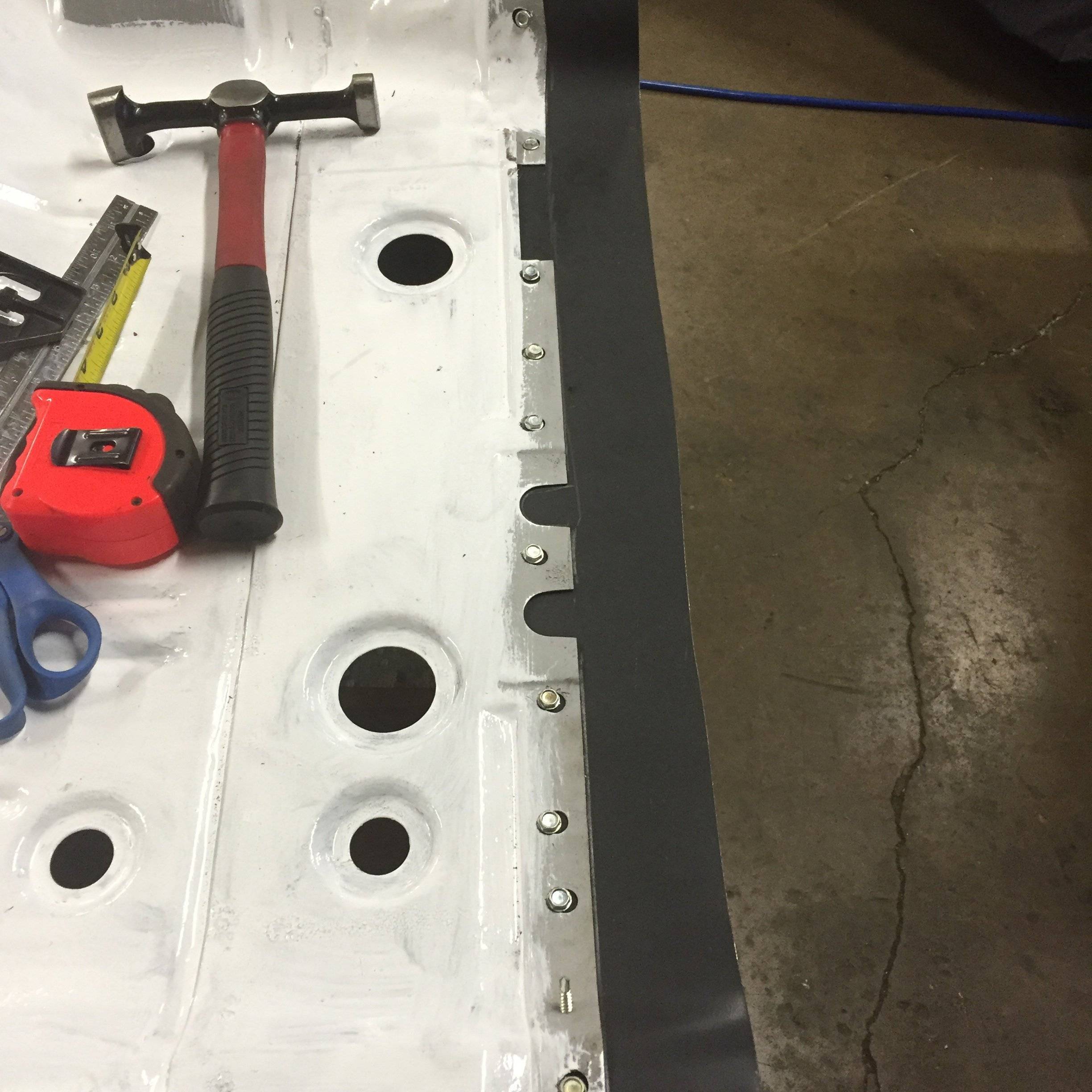

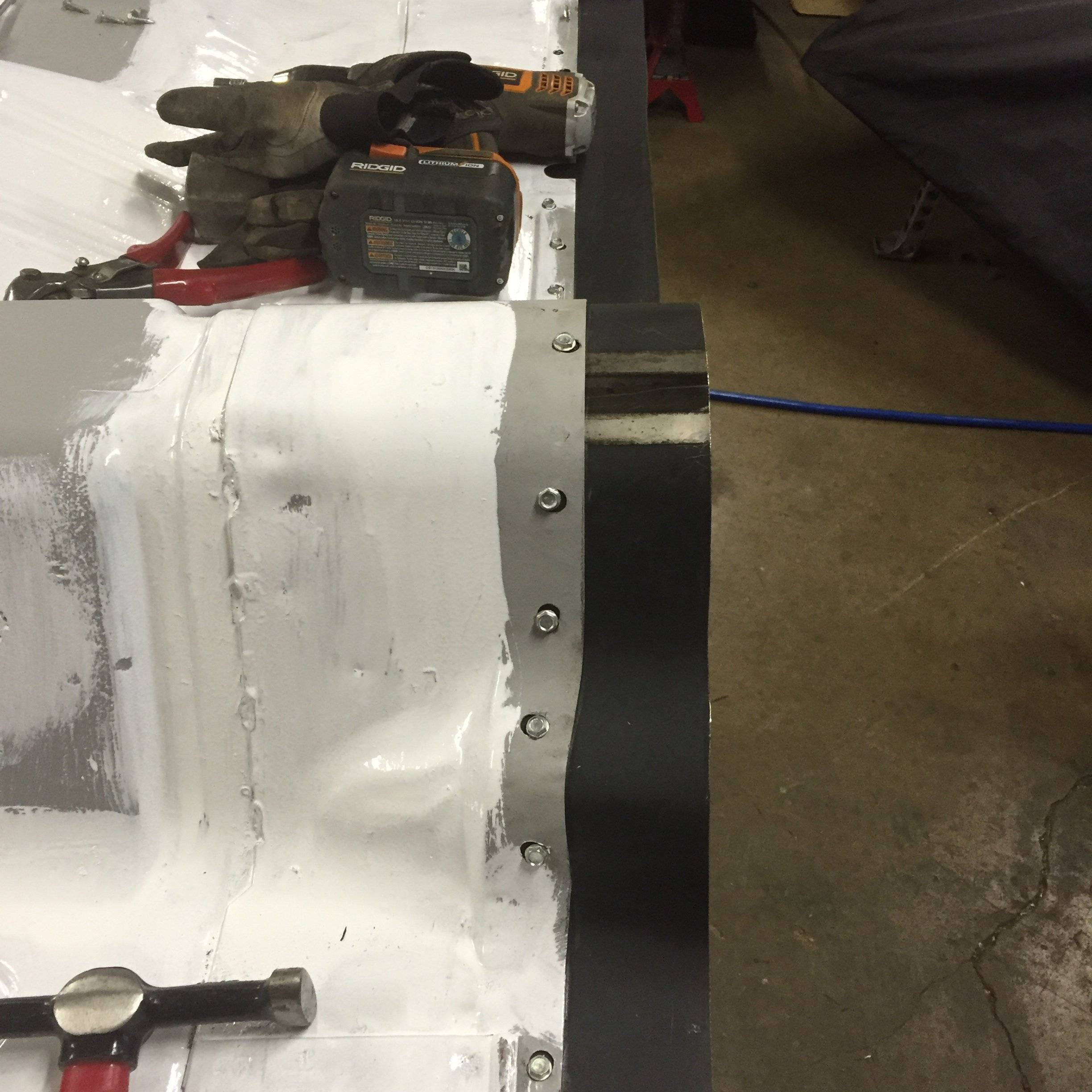

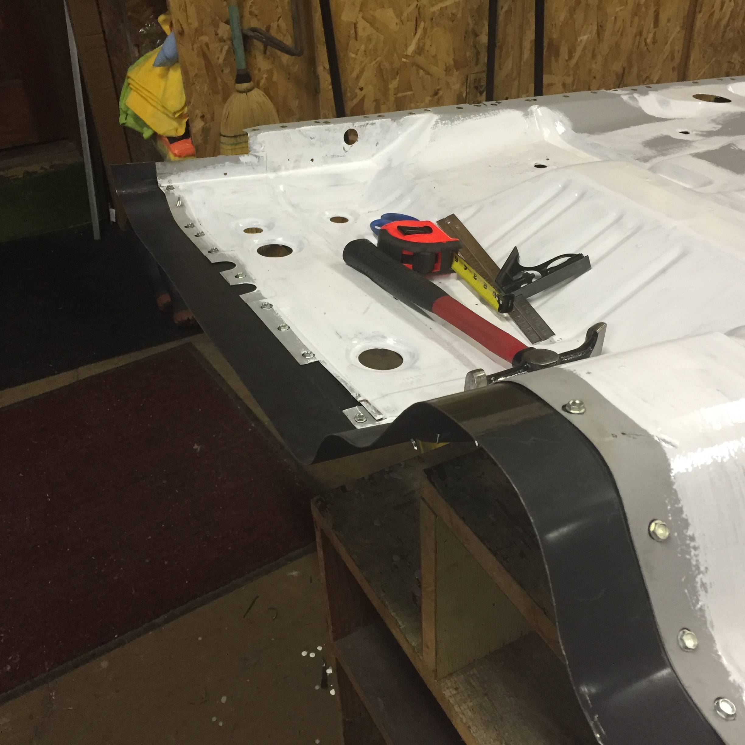

I fabricated the extension I need for thr floor pan today. Turned out pretty good for bending it by hand
I think you're doing a fabulous job... keep it up and you will want to smooth those 1/4s
Just a dumb-*** question. Is the new pan shorter, or did you cut more off the original?
Not a Dumb *** question.
No I didn't cut it shorter, it came from a 65 Fury.
The front section is identical to the Polara but the rear section where I attached my extension is shorter in a Fury so I had to extend it by 3" to make it fit my car.

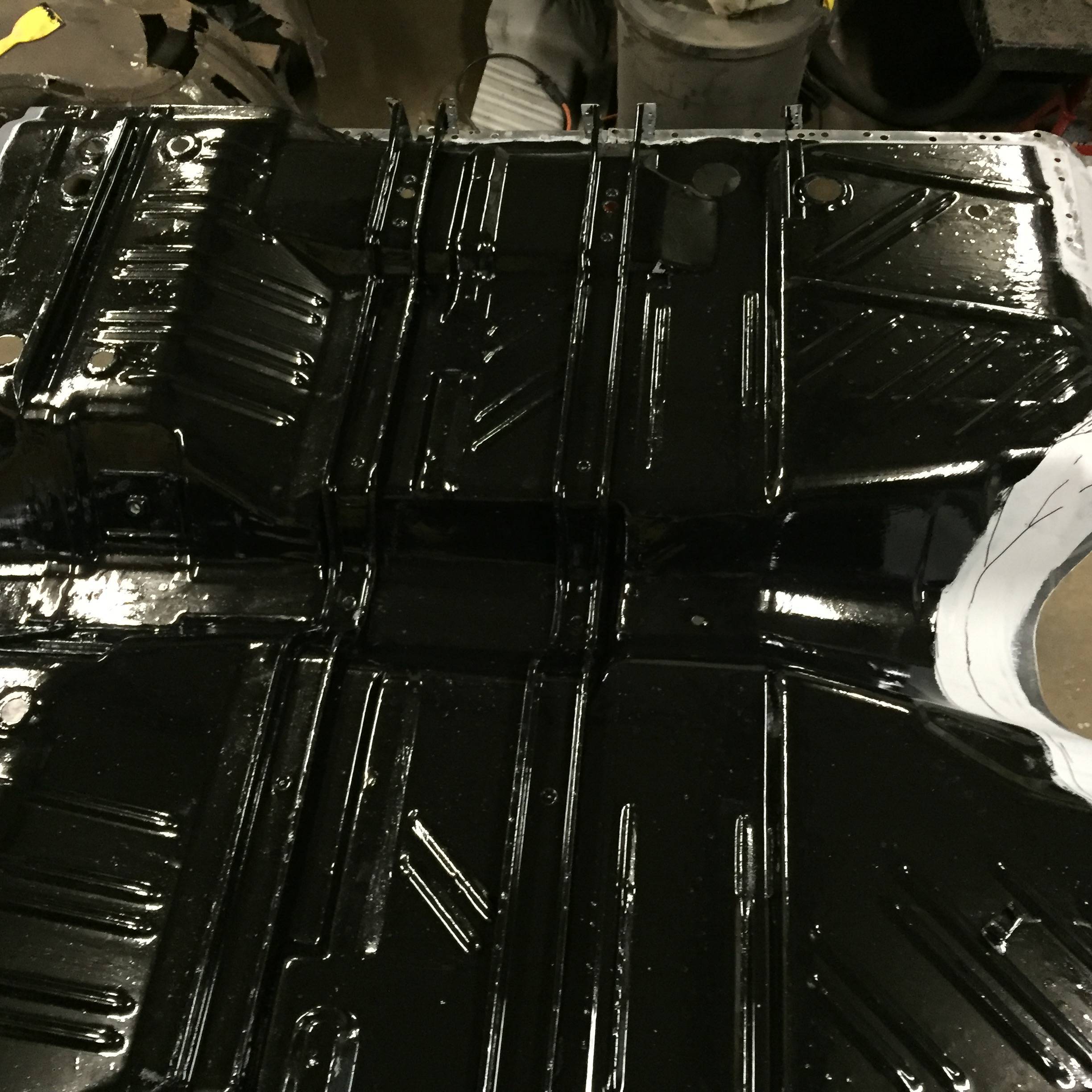

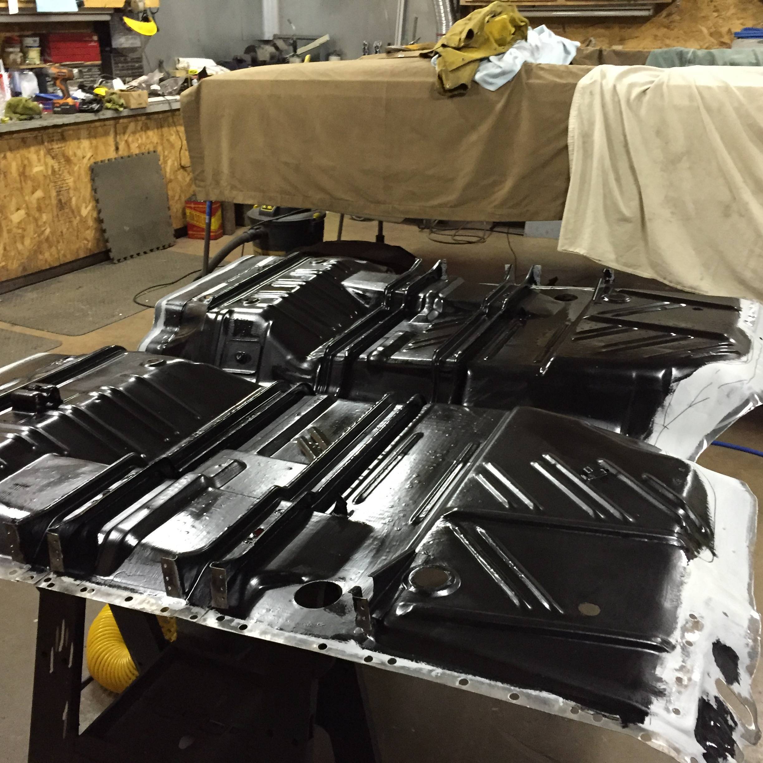

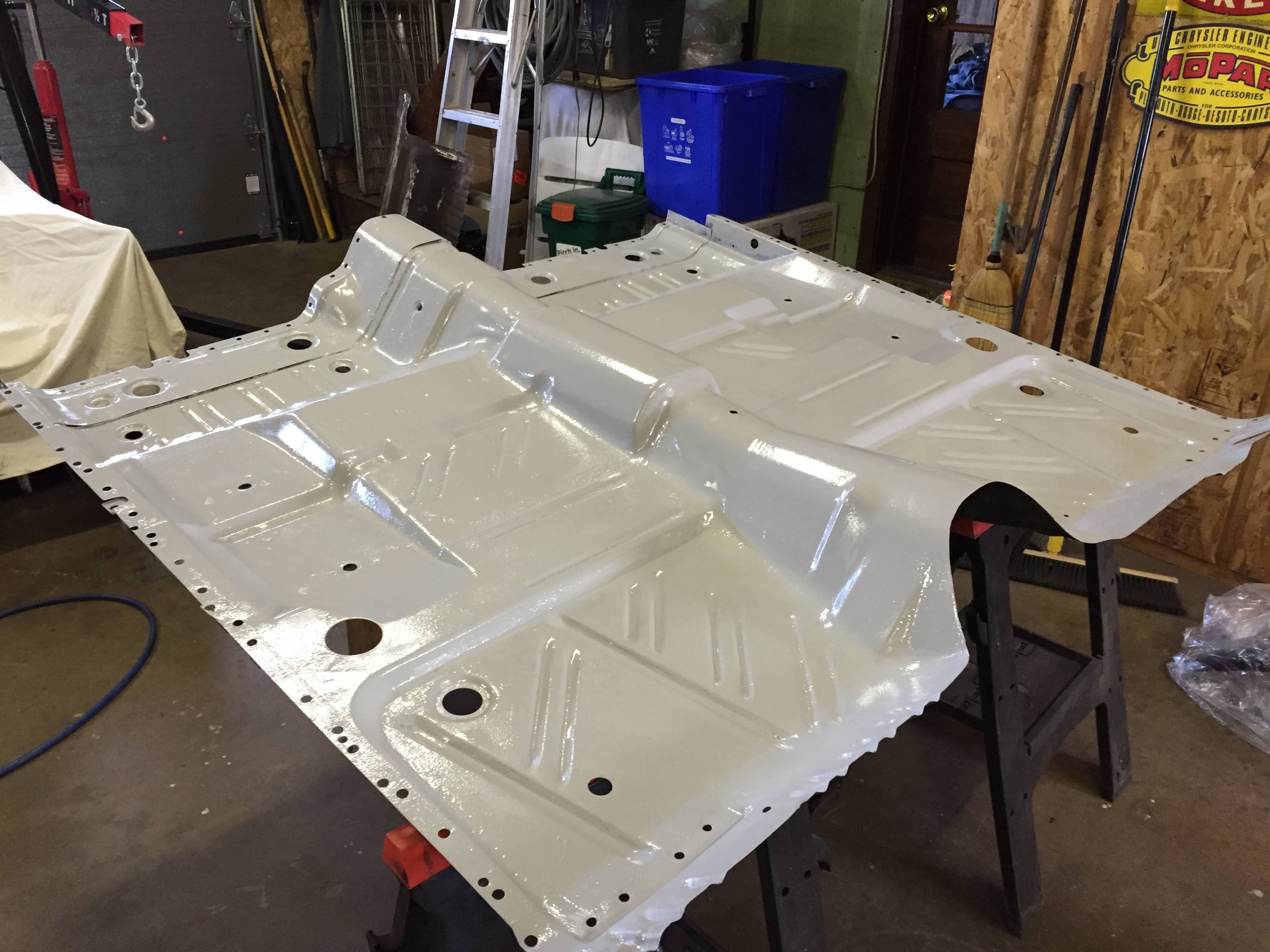

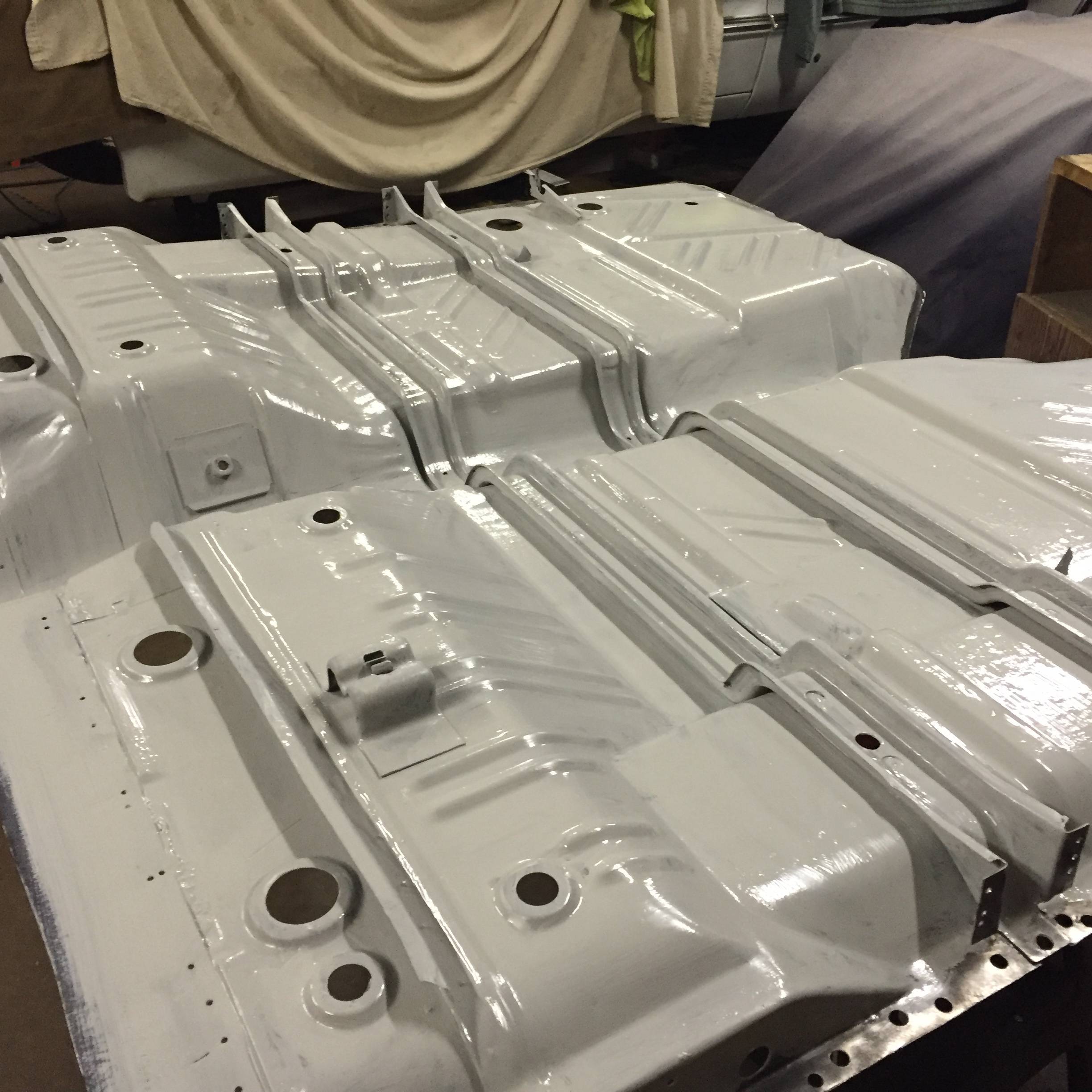

I painted thr underside tonight...the stamping #'s are in amazing condition
I added the black Rust Bullet to the underside of the floor pan leaving the edges for now. it will be much easier to touch up the section rather than painting the entire pan on my back when it's installed this weekend.

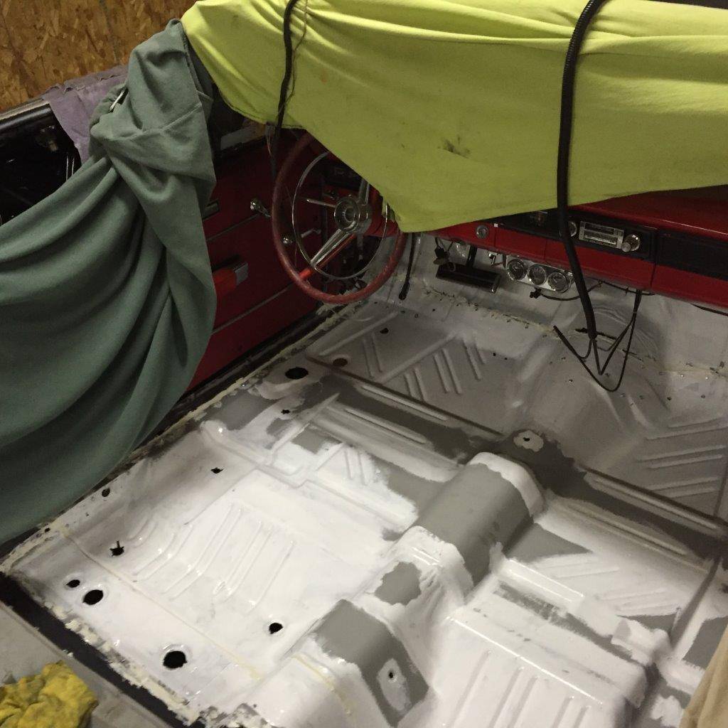

I also primed the floor in the car in preparation for the installation..
I added the satin black tonight. It should be installed tomorrow morning after another test fit

I have covered it in the white rust bullet which is a blindingly gloss white..
The under side as you can see is going to be a satin black front to back which I know was body colour but this is not the car to try to do that with since it has undergone many colour changes in its' life.

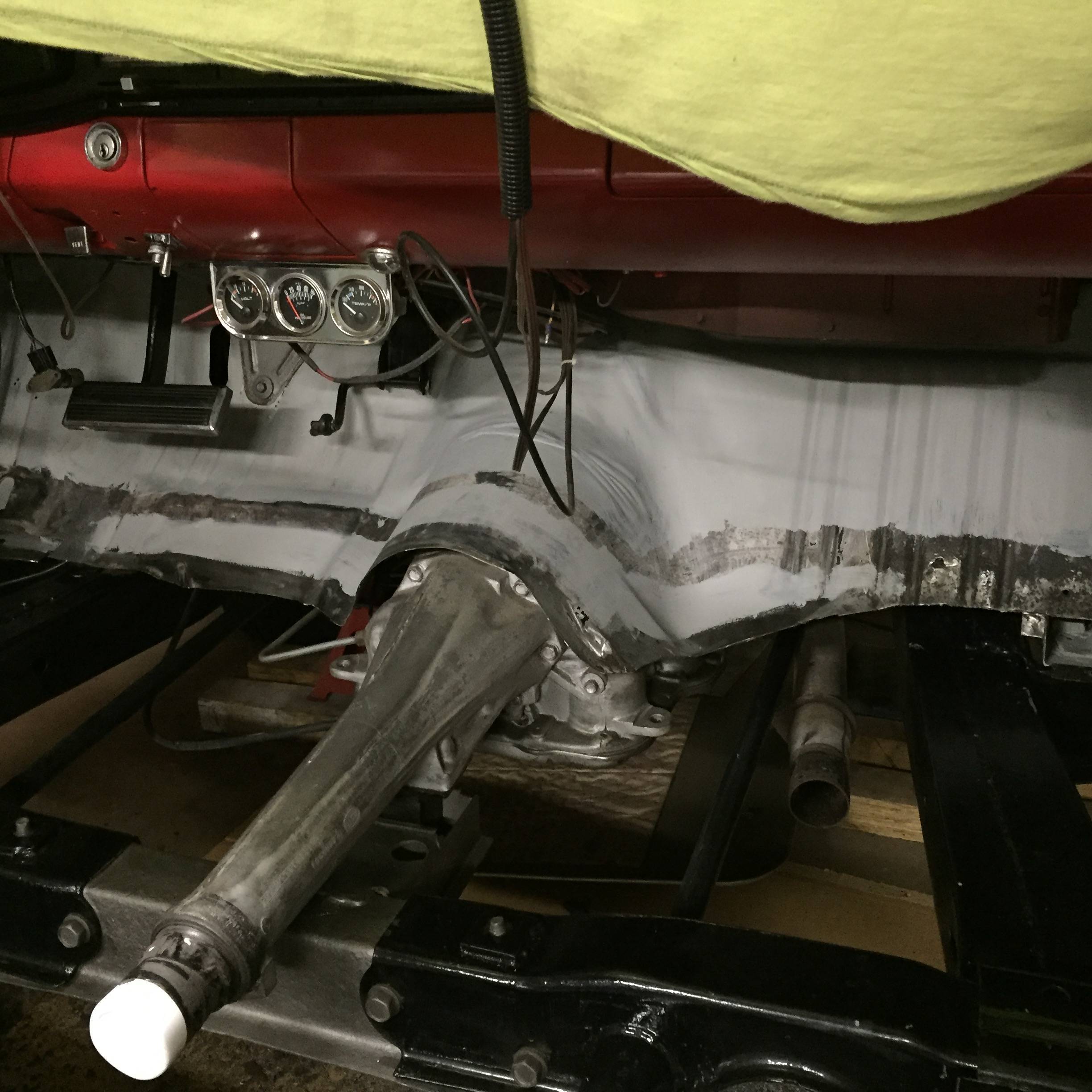

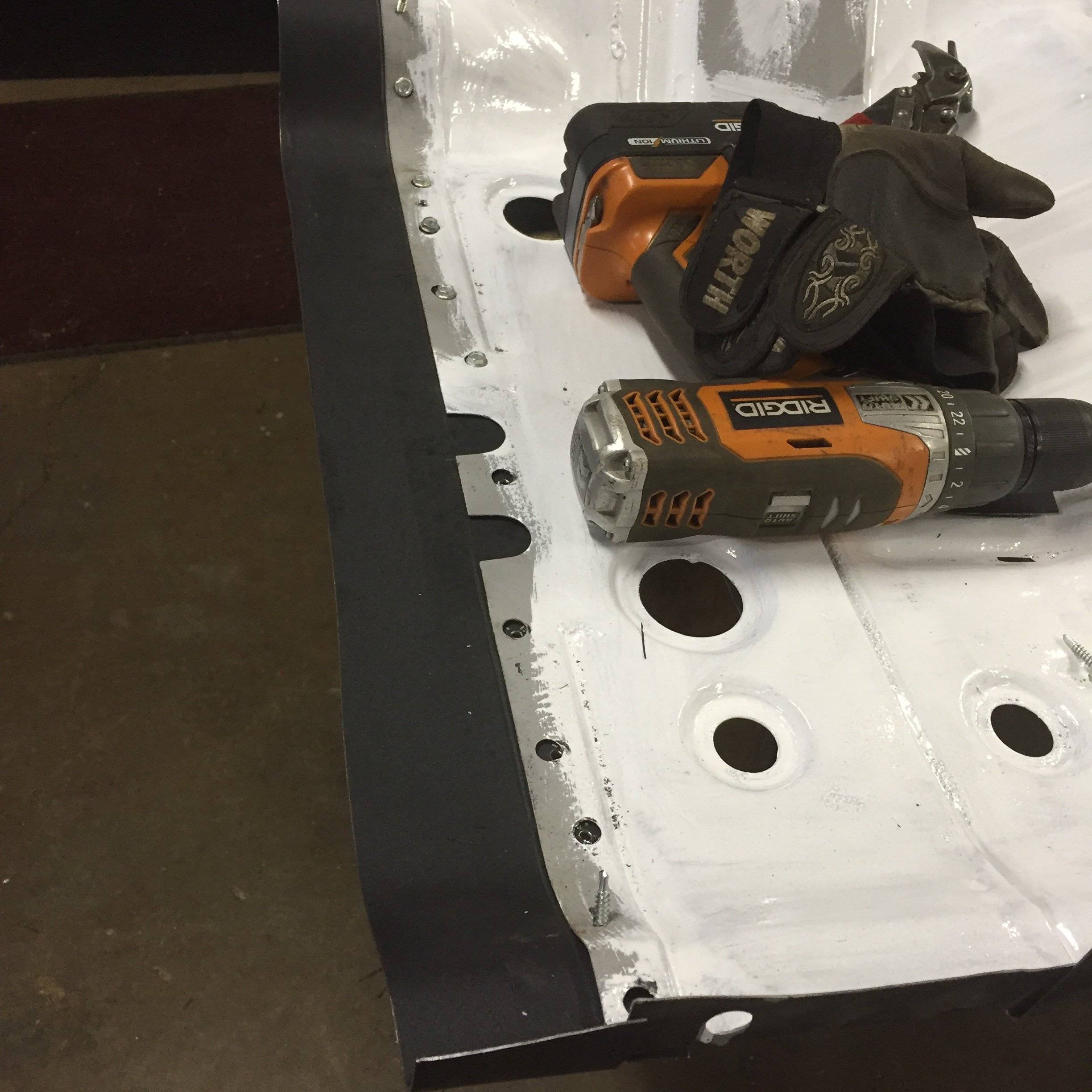

I installed the pan this morning and it is now setting up. I used the 3M 8115 body adhesive system & a # of self tapping screws to bring it all together.
I was concerned about pan distortion so I went this route.
Sealed the edges as well right away and it is now drying.
