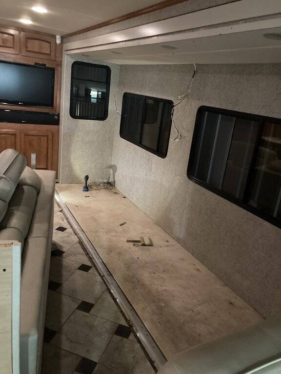

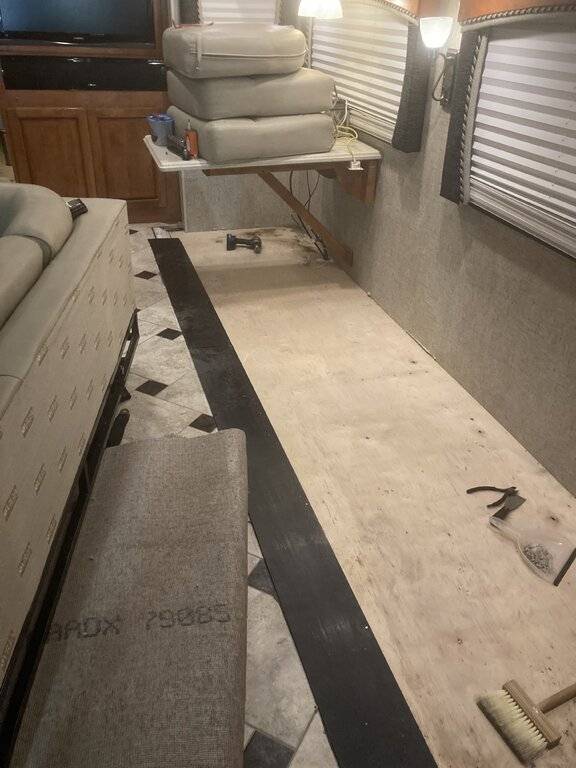

Now that I have finished the shop light replacement, I am replacing the floor in one of the slideouts on Bruno, my 2010 Holiday Rambler Endeavor diesel pusher.
Pulled the hide-a-bed couch, dining benches, side trim and the carpet.

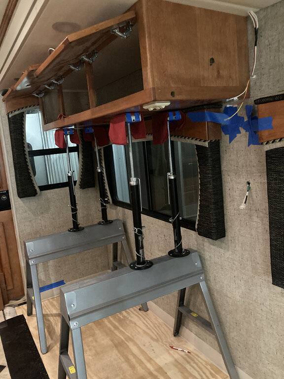

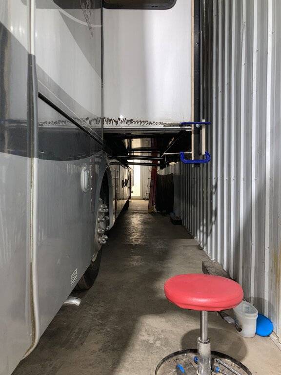

I have some adjustable support jacks arriving tomorrow that will support the slideout after I disconnect and retract the slide mechanism.
I will then measure the floor and have Menards rip the plywood to the same depth.
I will have to scarph two pieces together as I need approximately 13’ in length.
Quite the effort, but I am grateful that I have the capability to do this.

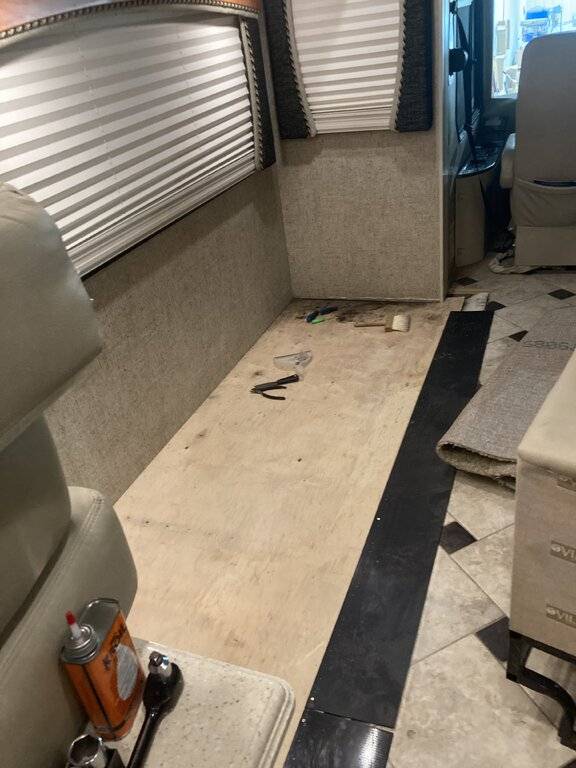

The floor in the RV got wet and the plywood layers delaminated.
The fun continues.
Pulled the cabinets above, interior window frames, dining table and lights above the area.
Tomorrow, I will retract the slide a bit and pull the aluminum frame inside.

Please be careful with the slide out mechanism. If it is a Lippert system using two geared tracks and one ram, the drive bar mechanism that goes from one side to the other is under a large amount of tension and you can easily get hurt. That slide out weighs an awful lot so please be careful.
I am being very cautious.
The slide out is completely hydraulic. I believe it’s a Lippert.

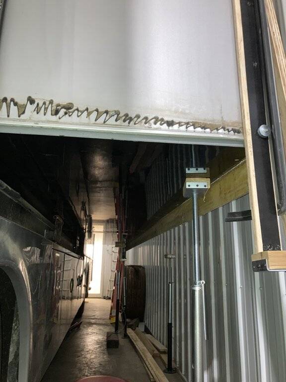

I have 8 screw jacks. 2 or 4 of them will support the roof on the inside.
I have already removed about 500 lbs of weight from the cabinets, hide-a-bed couch, dining table and benches.
I am going to have to remove the interior walls to get to the lag screws that go through the slide out frame into the slide out floor.
I figure that just the floor weighs about 300 lbs.

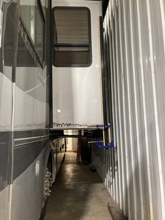

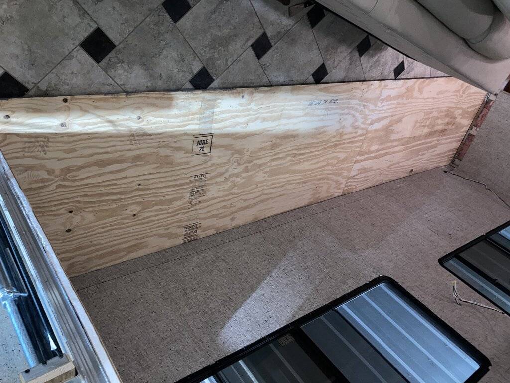

This one is 13’ long. I have to splice 2 pieces together.

This evening, I installed all of the support brackets, screws and nuts, delrin slides, removed the screw jacks and did a limited test (not full stroke as the couch and dining table benches are in the way).
Success! The new floor installed is smoother and the slide out doesn’t make any creaking noises as it moves.
On to installing the rest.
My plan is to be done on Saturday.
Today is the day to finish!
Cordless stapler crapped out and this was the first time that I used it. Manual mode.
I should have everything installed today.
