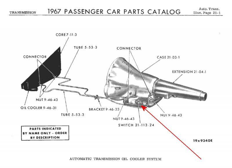

Mar 27, 2014 #3 MrMoparCHP Old Man with a Hat Joined Aug 9, 2013 Messages 6,343 Reaction score 6,728 Location Naselle, WA This should help... Alan
