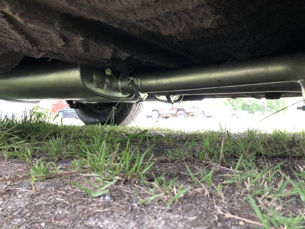

So after a brief chat with TTI it seems Mancini messed up the order.
They provided the right pipes but they provided me with 2.5” flanges for HP manifolds, which are incorrect for my 2.25” LP Log manifolds. I suppose I could find and source a set of HP manifolds, which would be something I’d want to do later down the road anyways, but I’m just going to cut off the 2.5” flange, install a 1/2” thick 2.25” flange and weld a small piece of connecting pipe. Everything else seems like it’s good as long as the hang it going from the rear, forward.
I should of noticed this earlier.
TTI’s customer service was very helpful and friendly so that’s always an upside.
