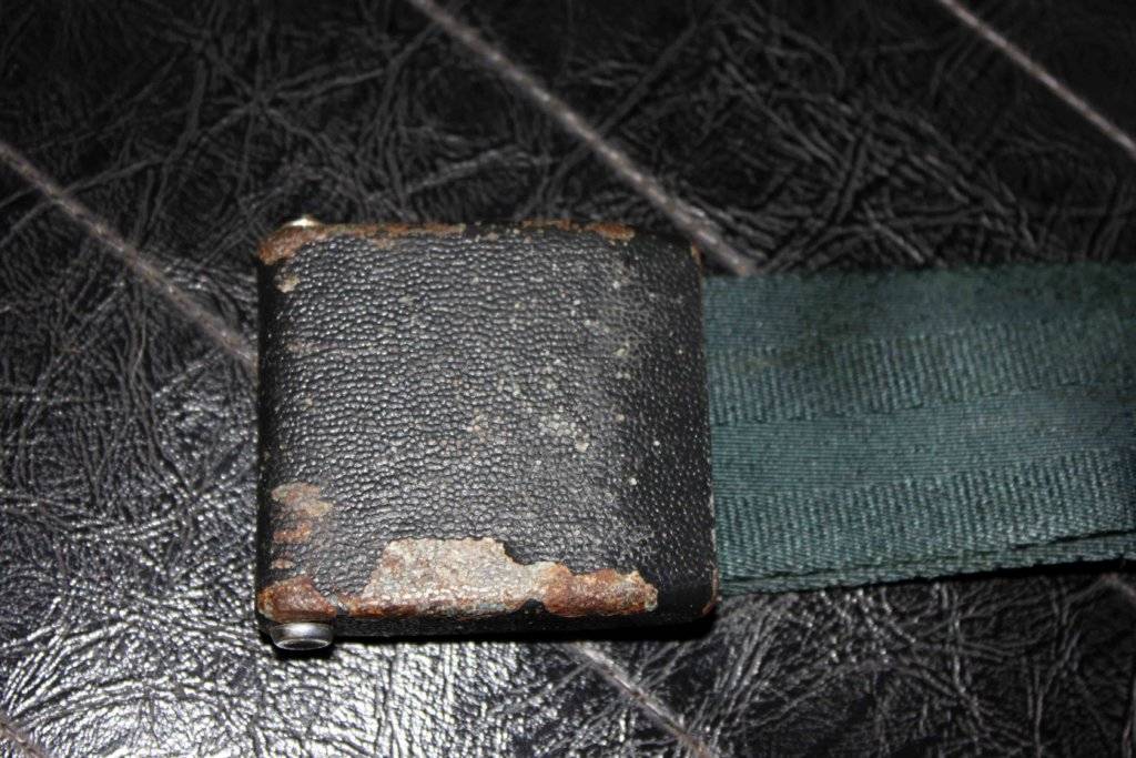

I am in the process of restoring the seat belts and interior on my 68 Fury. I have a few methods to re-dye the black webbing of the seat belts, but was also looking for a way to redo the texture paint on the metal seat belt latches. Has any one done this before or have any suggestions? I was considering using the wrinkle paint used on the air cleaners or some sort of chip guard to get the texture , but wasn't sure if it will look factory.

Not being familiar with the particular buckles and their paint, I would suspect the pattern is embossed in the metal and then painted. For a better consistency of the pattern and paint. At the least, you can clean the coating off and re-do it later. Pictures?

Here is a picture of it. When I bought the car, the belts had been buried in the seats for years. I just got my new upholstery and carpers in today and wanted to do something with the seat belts while I have the interior out.

Am I seeing things or is that pattern stamped into the metal?

Hello! Ah those Damn seat belt buckles! I took my 1968 Polara Coupe buckles over to my bench buffer and polished that crap off to a nice bright hue. You even get to see the pattern. Hit it with clear coat DONE!
