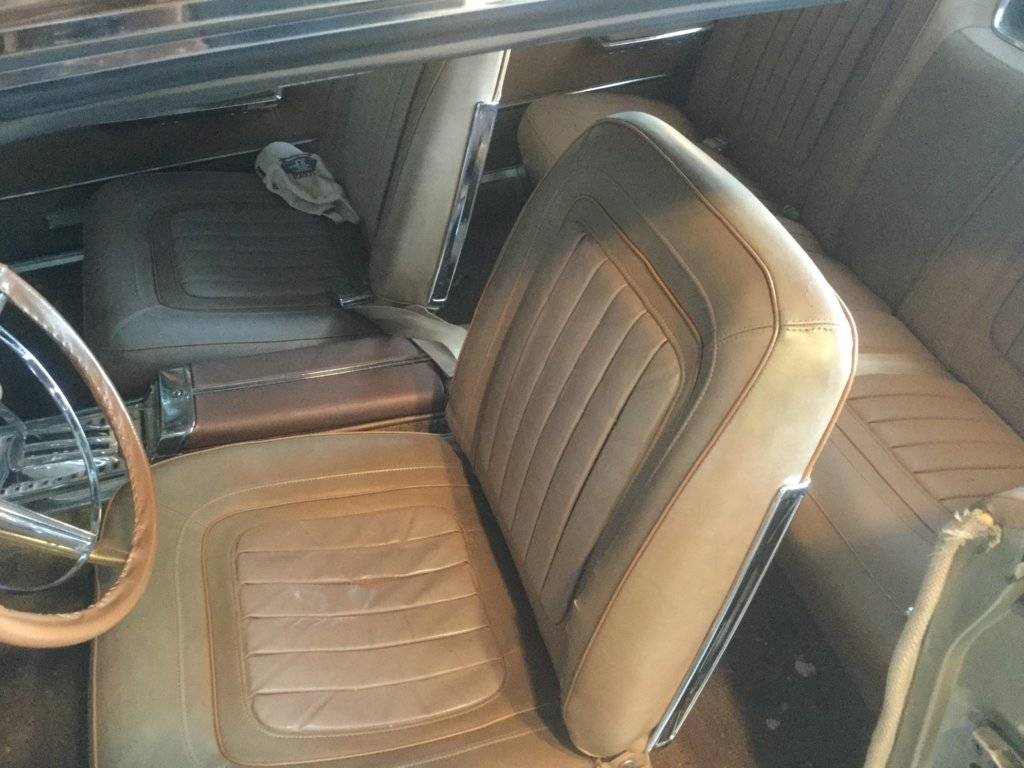

I’m getting the seats recovered for my Monaco.
I want the exact pattern copied but......
The stitcher asked me if I wanted all the seat welting also to match original. Initial response was “of course” but now I’m thinking of leaving it out.
This seat pattern has a lot of welting or piping in it and I’m not wild about the looks of it.
In previous cars this welting has cracked and broken long before the cloth or vinyl showed any wear.
This is the pattern with all the welting.^^^^^

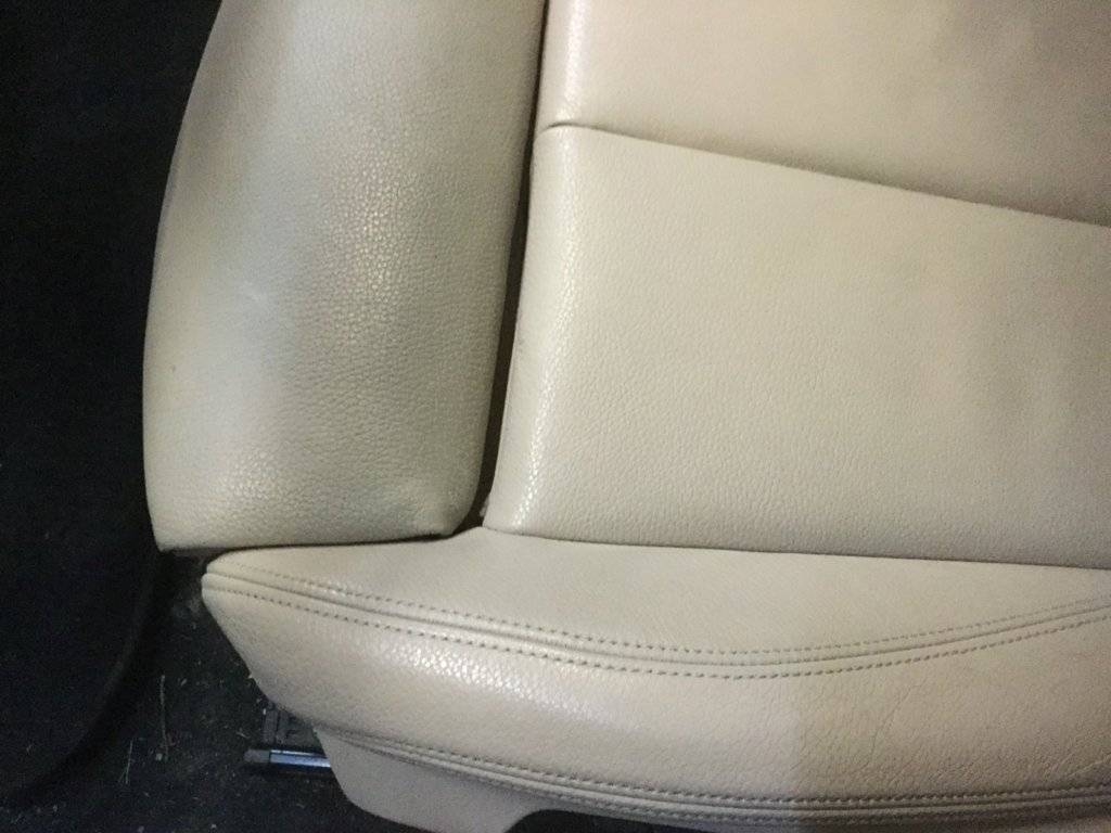

I like the looks of the seams on my daily driver better. Shown below.

Well. . . Dan. . . I don't usually follow the crowd, but this time I'm gonna go with them. Without the piping, etc., I don't think the interior would look right.
If you went with a modern pattern people are going to be asking you what the seats came out of.
It will look like you went to the salvage yard and got seats out of something modern, which would probably be a lot cheaper than having yours re-done.
Another vote for original.
The old original welting was more of a plastic material, whereas some of the new welting is vinyl sewn around a cord. It is a little softer so shouldn’t crack as easily. It still has the same effect of holding the seams together.

My guy, or more specifically his daughter, makes the welting with the same material as seats wrapped around cording. The color mismatch of a vinyl welt vs the seats was my concern for maybe omitting it.
Incidentally, when I dropped the seats off I asked about the welting. The whole shop started laughing. They had just discussed the same thing 5 mins before with a customer getting his A body buckets done. He went without the welting but had them do a lap type seam that kinda mimics the welt seam.
FWIW. The vinyl sample I received from SMS is a much thinner material than the factory material in the car. Color and grain looked like a good match though.
Finally stopped by the upholsterer’s shop today. Another business shut down by the Governor. Jeez, it’s a father and daughter shop yet they were forced to close. She did take one of the bucket seat covers home with her for patterns and cut all the pieces.
A lot of pieces in this design but it looks like she got it just right.
