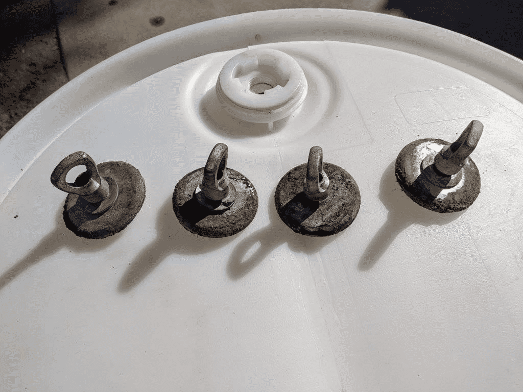

Here's some stock rear belts. Yes, they used eyebolts for the optional belts, but you don't need to.

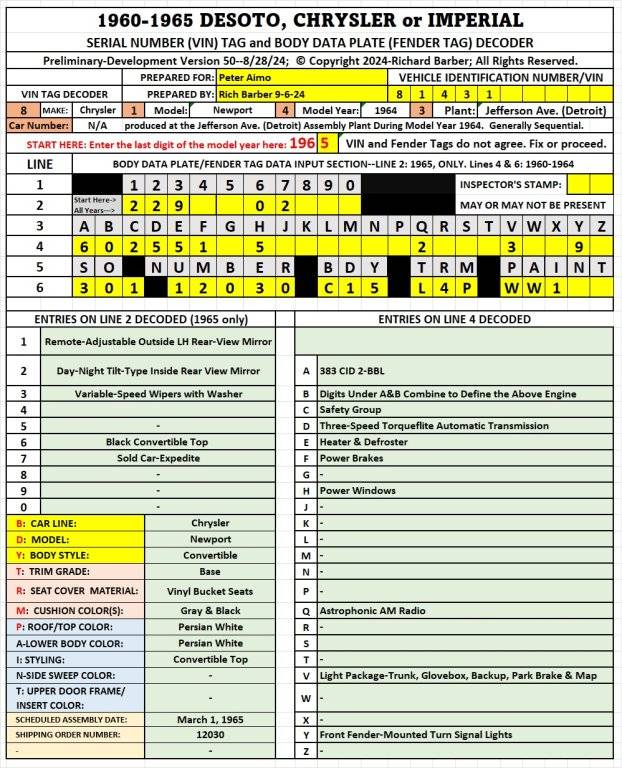

I can't help with the belts but note an unusual trim detail around the front bumper end. I would appreciate receiving a picture of the car's fender tag to help me with the development of my decoder. I will decode the tag (no charge, ever) and the VIN if you want to share it. VIN probably begins with C153 and that is enough for my decoder-sample attached.

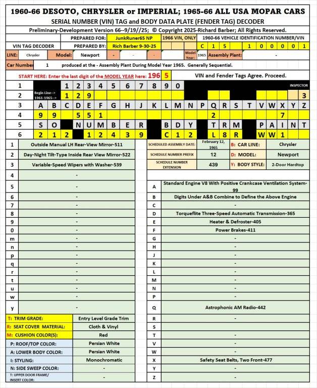

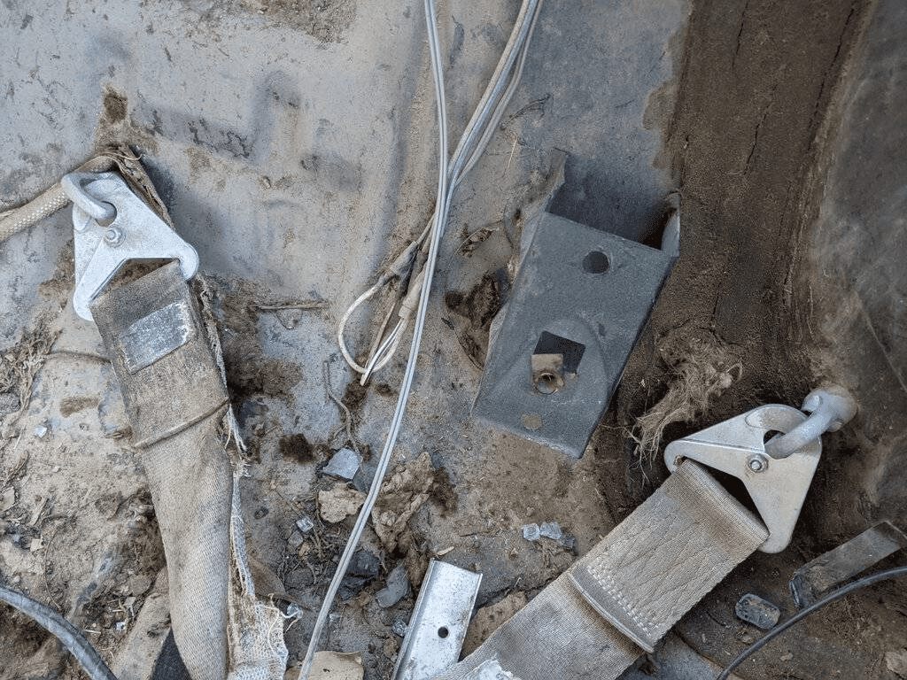

Pretty sure there are at least two pair of seat belt anchors welded to the bottom of the pan. These would include a reinforcement plate and a welded on fine thread nut with protective rubber plugs in them. Poke a pick up through the carpet to pop out the rubber plug and locate the attachment points. Use a flat washer underneath a standard eyebolt anchor and attach belts. Similar attachment locations may be found beneath the back seat. Look on the sills and the hump. more seatbelts more seatbelts (I did not notice the previous excellent information on seat belt attachments) I could run your car's fender tag daat through my decoder. N/C, ever. Just need pix of fender and VIN tags. Example below.
