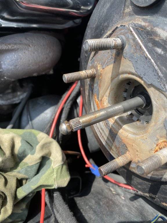

Did you check the travel rod adjustment for the booster?
at the very end of the rod behind the curve you can put a small wrench on the 6 point star and hold the splines that are behind it. it will move and adjust out. also I use to have a 66 Plymouth vip with single master cylinder and power booster the Chrysler system is so sensitive if you breathe on the pedal it will throw you into the windshield. check and recheck all parts,especially new wheel cylinders. if made in China they can have to large a bore and I have seen the pistons get crooked and stuck inside so it feels like the pedal is also to the floor. adjust that the rod out first though and recheck.
at the very end of the road behind the curve you can put a small wrench on the 6 point star and hold the splines that are behind it. it will move and adjust out. also I use to have a 66 Plymouth vip with single master cylinder and power booster the Chrysler system is so sensitive if you breathe on the pedal it will throw you into the windshield. check and recheck all parts,especially new wheel cylinders. if made in China they can have to large a bore and I have seen the pistons get crooked and stuck inside so it feels like the pedal is also to the floor. adjust that the road out first though and recheck.
Hi ok il try this I just presumed it didn’t adjust!
How much adjustment is needed do you happen to know?
I usually run the rod out until it hits the inside of the piston on the master cylinder and turn it about 1 turn more. there may be an adjustment in the manual but I dont remember. if memory serves me I believe there is a difference in the power brake master cylinder and manual brake. years ago I remember I had a car that it took a while to get the right one, and I dont remember what the difference.

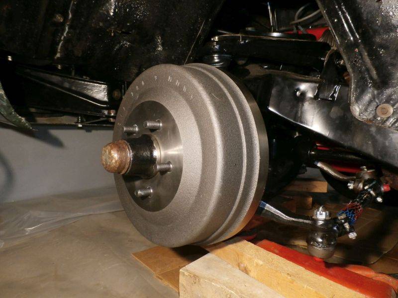

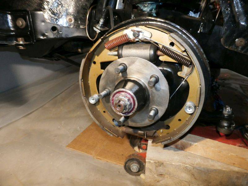

I recently did this for my '67 Monaco front drums, probably looks exactly the same as your '65.
Separated the hub from the drum, pressed in new studs (could have used the old ones, but the new studs were like $1.50 each). Removed the bearing races and installed new races and bearings and rear seal. Cleaned up the hub and painted back side and front with DOM-16 (same as POR-15). New brake hardware, shoes. This is a 2.75 inch shoe and drum. Backing plate (and knuckle, upper/lower control arms, entire stub frame was powder coated). Lower ball joints courtesy of Mobil Parts. I fussed over what grease to use, wondering if what I had was "the best". I figured I couldn't do much better. Mystic No. 6 High Temp NLGI-2 GC-LB spec lithium complex.
Brake drums bought locally - damage rate due to shipping / handling seems high, outer lip ring seems particularly vulnerable. if I buy locally I can inspect at time of purchase. This is a "WinHere" brand product. China. About $90 CAD each ($62 USD) before sales tax. My old front drums were mis-matched, one weighed 15.8 lbs, the other was a little heavier. These new drums are 20.5 lbs.
