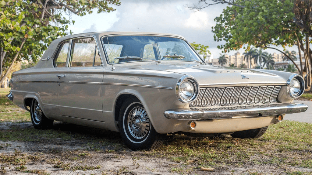

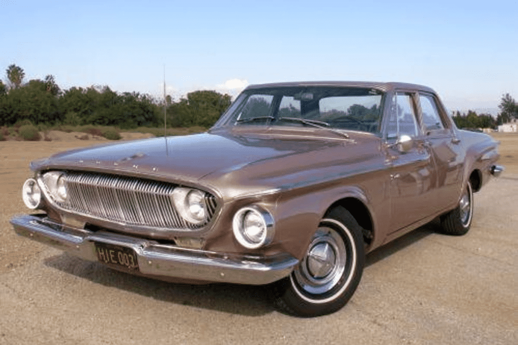

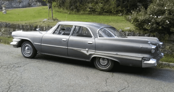

Well... The Dodge Dart started as this in 1960
Went to a B-Body in 1962
Then to an A-Body in 1963
