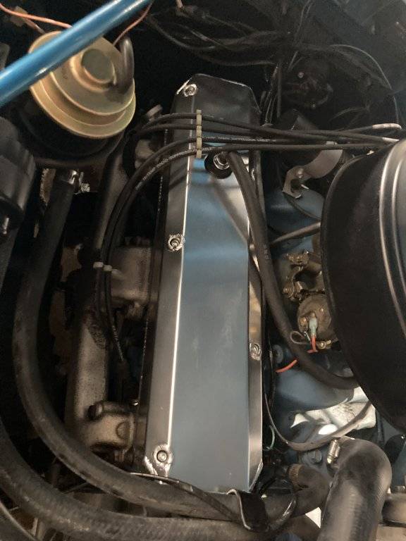

Today I installed the Mr. Gasket MRG-6860G valve cover on the passenger side with a Moroso 93050 gasket.
I bought the Mr. Gasket 6377 grommet and a Standard V178 PCV.
I torqued the valve cover bolts (with a little anti-sieze) to 75 inch-lbs.
I also applied a thin film of silicon grease to both sides of the valve cover gasket.
No leaks! 8^)

What made you choose 75" pounds? Was that in the directions for the Moroso gasket?
Asking because factory spec is 40"lbs. Thanks, Ben
They listed the torque specs on their website as 80-100, if I remember correctly.
The valve cover instructions listed 5-6 ft-lbs (60-72), so I took on the high end of the valve cover and low end of the gasket.
There’s no flipping way that me and the inch lb torque wrench can get to anything more accurate (read: the slop covers and can’t guarantee anything so tight in a setting).
So that’s what I used.
