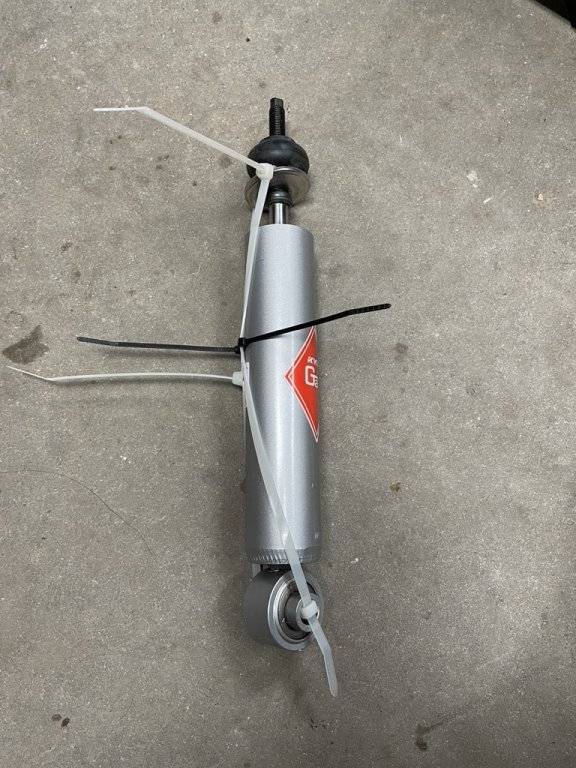

Thanks to everyone who suggested the KYB shocks!
My front set did not come with the strap. The picture shows a 36 inch zip-tie used to reduce the length by 4 inches to create the needed clearance.
Two suggestions (or one old fools opinion);
A) For the bottom of the front shock (top of rear), create some space for installation by using a threaded rod, two thick fender washers, and two nuts inside the mounting members. Using the nuts to push out on the washers may give a little free play before installing the bottom (or top rear) of the shock.
B) Shocks, as with most suspension components, should have the final tightening/torqueing of the fasteners with the vehicle at "normal" ride height.
Again thanks for the suggestion on the KYB gas shocks and the installation techniques.

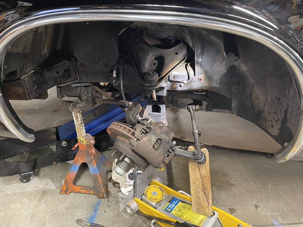

I just did mine a few weeks ago. 1970 300.
I used my press rather than compressing them by hand. The press isn't really needed, but it made it really easy. For the straps, I got some long zip-ties from Harbor Fright and went through the lower eye and up around the rubber. Then I put a smaller zip-tie around the large ones to hold them in place until I got to the car.
I separated the upper ball joint. I clipped the small zip-tie right before inserting the shock, then once in place, cut the large zip-ties and let it expand into place.
Hardest part of the job was separating the passenger side ball joint. I've separated ball joints before and this was the most stubborn ball joint I've ever encountered.
