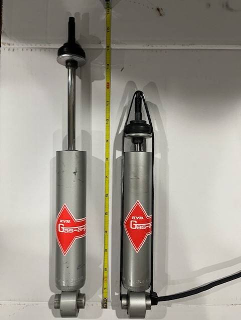

Yes. All shocks will expand with no load. Need the front ones fully compressed to install v
Actually, it's the gas charged shocks that expand. A conventional shock absorber, like the OEM on our cars, isn't gas charged and won't expand.
I don't think that gas charged shocks were readily available back when our cars were built.
If it's a gas charged shock, yes. Conventional shock that's not gas charged, no.
