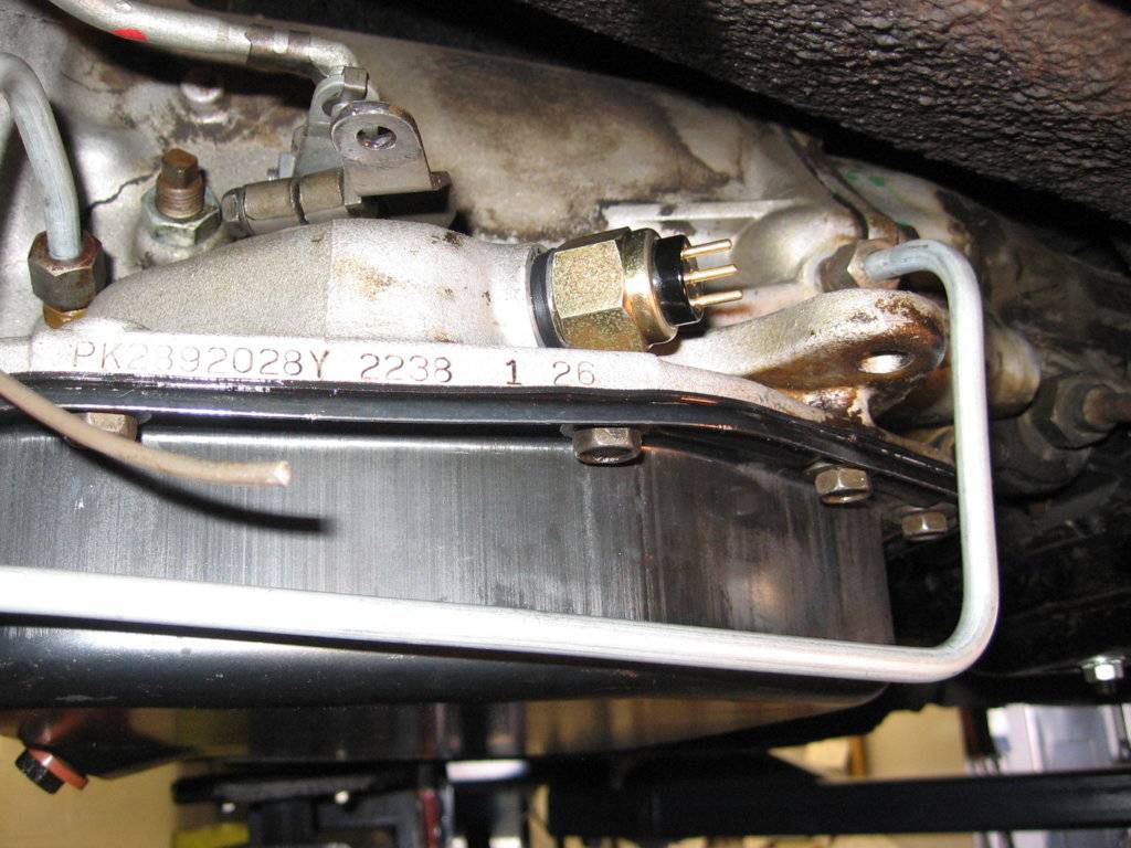

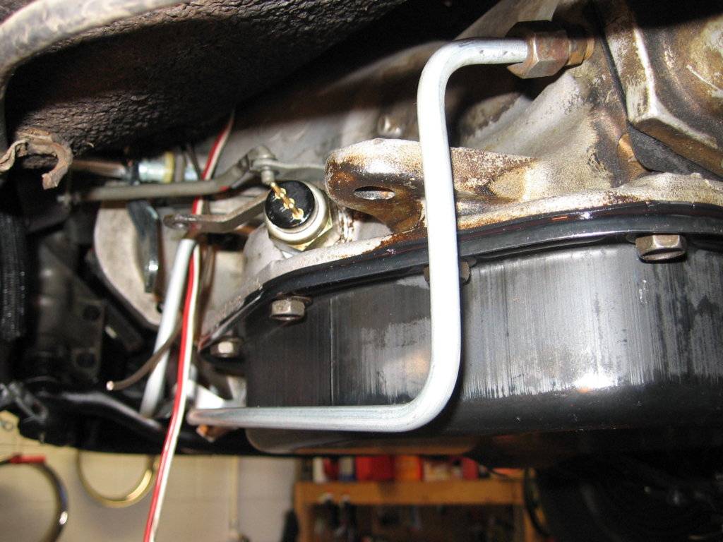

Just some photos for you.Switched from a single to a 3 prong on my 68.The column switch was broken..Got the parts from Rock Auto, order for a 1970.Don't forget to order the 3 prong plug too.View attachment 289109 View attachment 289110 Be sure the length matches to work the rooster comb.I believe the length changed in the 73-up years if I remember. Run extension wires from column switch wires thru the fire wall and follow the path of the neutral safety wire to transmission.You can see the brown wire is for the neutral safety center wire.I used red+white for my 2 wire extension to column.Don't matter what color and they hook to the 2 outer wires from the plug.They can hook to any side as they just complete the ground.
P.S. If you change the valve body to the part throttle kickdown type, order for the year of the valve body. Hope this helps.

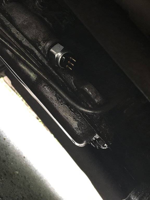

Thanks! I just swapped switches. Getting ready to do the wiring.
Edit-the 69 switch works but not as planned. Backup lights are on in forward or reverse gears.
