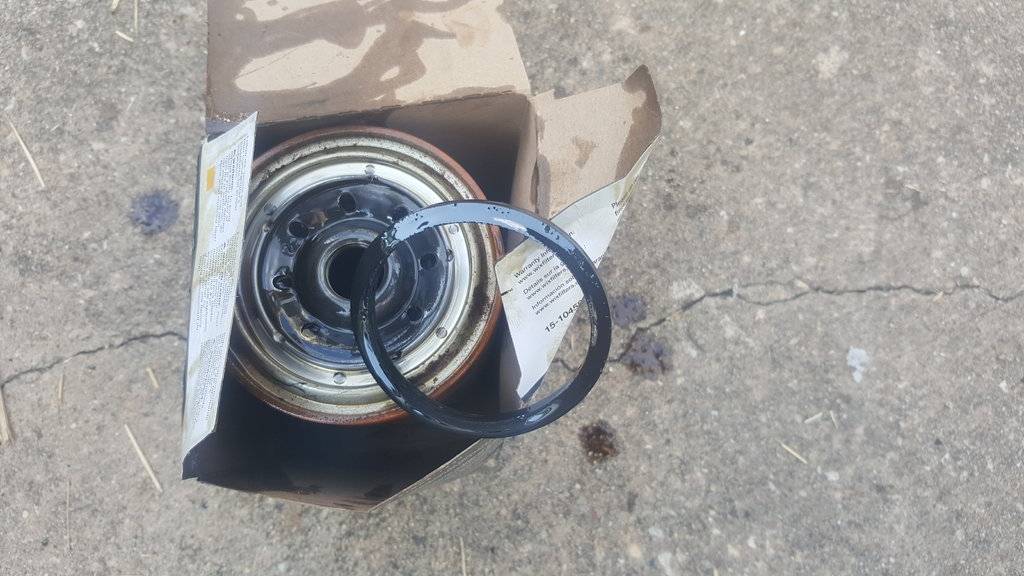

was out this morning changing teh oil, wax on wax off, everything was splendid. brand new zinc valvoline oil good to go.
start it up, give it a few licks, and i hear the worst ever engine quief gurgle belch noise ever heard. somethings not right. houston! there is absofknloutely a problem! shut er down Norm, shes slingin Earl!
so WTH, the whole underside is drenched in oil - 5 quarts of pristine 50w racing oil with extra zinc are now in my driveway -
it looks like the filter failed somehow in some way at the seal -
when i was a hatchling and worked at jiffy lube it was common to see people taking off the old filter and Not check to see if the old rubber seal was On the filter and not stuck to the block...
then theyd screw the new one on,again without checking.
its the first thing i thought of,cause frams usually dont go bad.
so i tighten it down more than i should have to, wipe it dry, and pour 1 quart in. theres a fkn drip. WTH. this is the first wix filter i usually use fram, but in reading posts on this highly respected forum, i switched to a wix. so im thinking about returning this filter and trying to understand why an oil change is taking a half a day, and now i need another 5 quarts of go fast oil, crapola.
i tighten it more, doesnt feel cross threaded, put the watusi on it. add a half quart of oil up top. IT STILL DRIPS. HOLY H CHRIST ON A STICK.
fk it i pull the filter off, and i find an O ring totally out of place across where the oil filter stabs on.
aand its this.... the old ring off the old filter stayed with the car :/

100% operator error. the wix oil filter is perfectly OK. the old grommet ring off the old fram stayed behind so i then had 2 o rings in there and did not see it. . .
10 quarts of oil later we are back in business.
