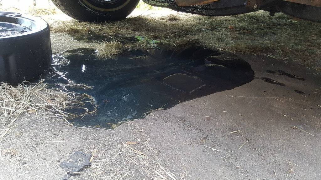

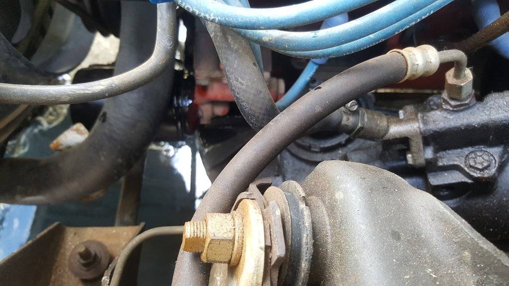

when i was a hatchling and worked at jiffy lube it was common to see people taking off the old filter and Not check to see if the old rubber seal was On the filter and not stuck to the block...
then theyd screw the new one on,again without checking.
its the first thing i thought of,cause frams usually dont go bad.
Had that happen once to me way back in 1975. Was changing the oil in my sister's 1974 Capri V6. Finished, went off down the road to check, immediately smelled oil and got it back. Yep, leaking through oil filter as there were now two gaskets under the filter. First and only time it ever happened and I started changing oil back in 1970.

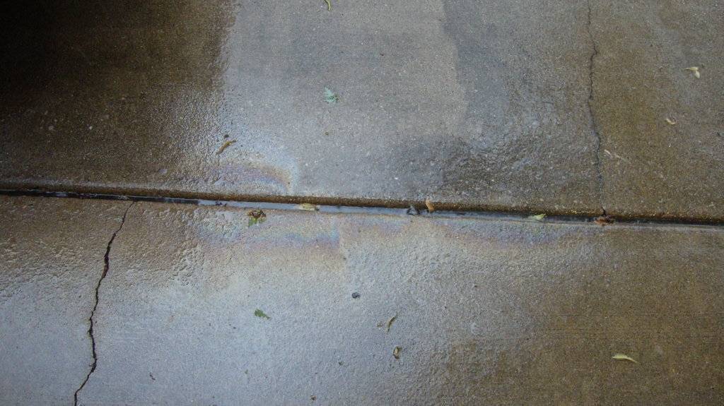

Ahh so your driveway will make pretty rainbows for a while.

was out this morning changing teh oil, wax on wax off, everything was splendid. brand new zinc valvoline oil good to go.
start it up, give it a few licks, and i hear the worst ever engine quief gurgle belch noise ever heard. somethings not right. houston! there is absofknloutely a problem! shut er down Norm, shes slingin Earl!
so WTH, the whole underside is drenched in oil - 5 quarts of pristine 50w racing oil with extra zinc are now in my driveway -View attachment 135185
it looks like the filter failed somehow in some way at the seal -

Looking at the old filter to see if the o-ring is still intact is a great habit to get into. I also wipe off the oil filter mount before I put on the new filter. I do both steps to insure I don't burn up a customers engine.:)
