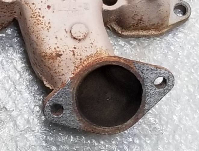

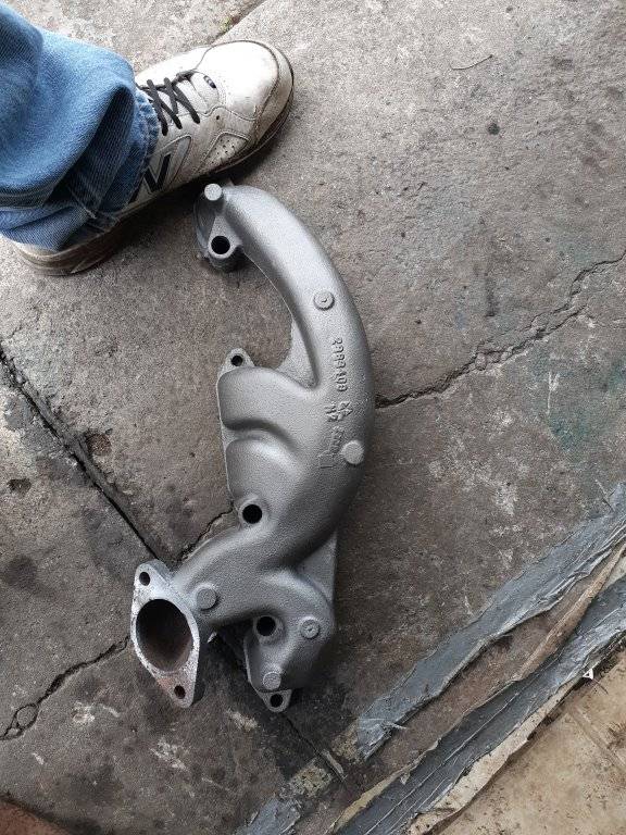

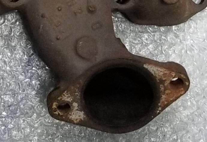

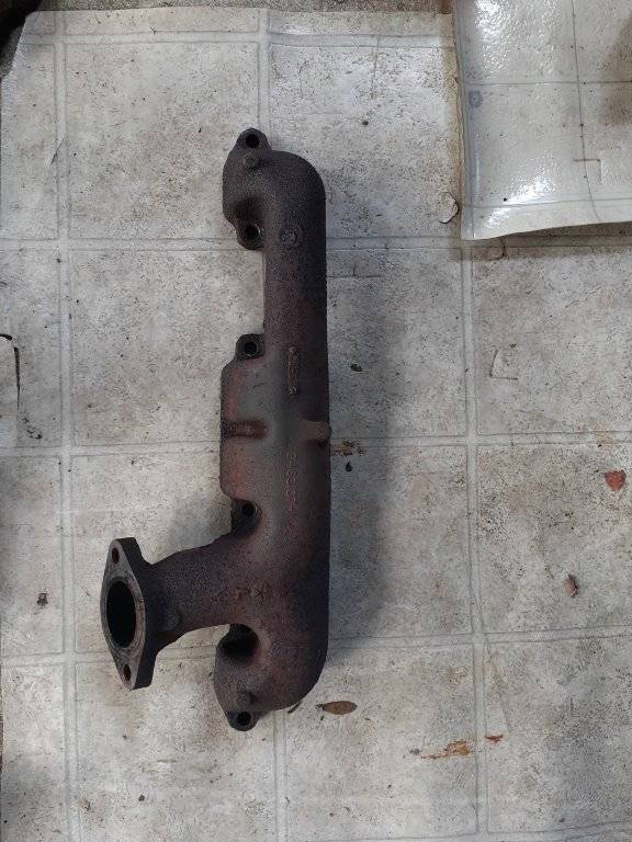

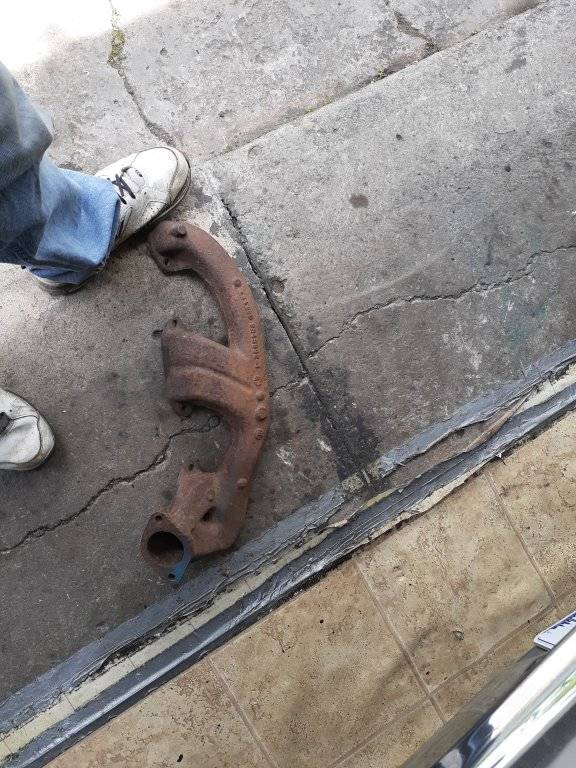

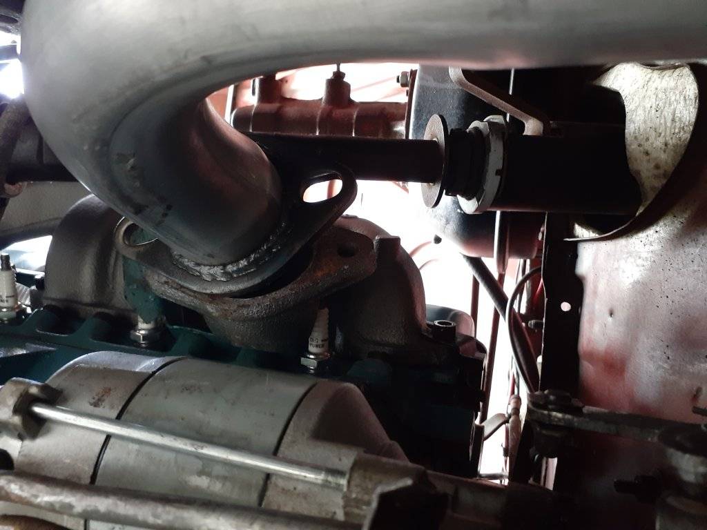

concern number 3 lol. the driver side is wrong. the flange touches on engine side no way on fender side, looks like it was made for b-body exhaust manifold. second from last photo is a b-body manifold looks like it was made for that one flange is pointed more down. last photo is the c-body one pointed towards fender.

Check the casting numbers on the driver side manifold, B-Body and C-Body use different manifolds as the steering gear location is also different. Parts book has the casting numbers. Passenger side is the same manifold. B-Body manifold is more valuable, so wou should be able to work a swap with somebody needing that manifold. Once you get the proper exhaust installed, you will probably need to re-jet the carb and advance curve to compensate for the lower restriction exhaust. A 440 is usually a lot happier going for peak torque at 4000 rpms or less. Above 4k you need high tensile valve springs with buffers to control valve float. Above 4k you should also consider 6qt pan with a windage tray.

i have the c-body manifold it fits perfect but i think they made the pipe for a b-body manifold. one step up bigger cam then the hp 440 cam plus new comp springs
tried the pass side it fits my hp manifold and not the log manifold so perfect there. on drivers side i put the log manifold on and it fits that. and the log looks more like the b-body hp manifold might fit that. so waldron must have made it for the log or b-body hp. hope they don't give me a hard time or takes almost 8-weeks to get the right one. is anyone using the waldron on there c-body hp manifolds ?
You have a 383 manifold on a 440. The position of the outlets are at different hights.
The relation of the "dot" cast on the manifold is an easy ID spotter to tell if its intended for a low-deck or raised deck application. The "dots" are roughly in the same location relitive to the cylinder head flange. You can see the 440 one is longer after the "dot" to reach around the steering column.
the rusted one is a hp b-body manifold and the painted one is the c-body manifold #2863409. 67 and 68 383 and 440 are the same i thought and just the head pipe would be made different. it clears the steering fine
tti list it as a 383-400-440 they just have 2 different part numbers for the head pipe coming off the manifold. the log manifold i took off it waldrons fits this one.

John at Waldrons going to make up a new right away, he did some research and the pipe he sent was for a 67 but when he looked up my manifold he said that it was for 68-69 so he will make a pipe for that manifold
