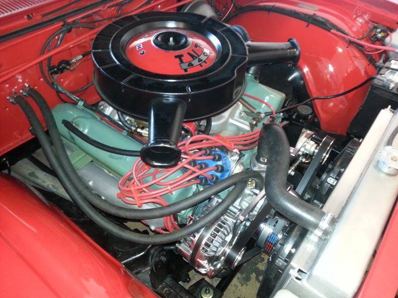

After my 300 sat for 20 years I tried to just tune it up but with constatnt overheating and only 12lbs oil pressure I knew it had to come out. I pulled the motor which gave me time to redo my engine bay. I paid a local guy 3500.00 to rebuild my 440 and trans. Of coarse I supplied him the cam and timing chain. Poor thing had 2 spun bearings 5 broken rings and a cracked piston. He said there was no way it ran but it did! He even painted the motor and cleared the trans. I put a shift kit as well in it and 2000 stall. Runs like a bear now. I probably put 50 miles a month if I get time. It was hard to find a guy in Austin tx that even wanted to do a mopar. Several shops told me they didn't want to do it. I was floored! They guy that did mine actully does marine motors and was the go-to guy in the day to build the chrysler 440s in the cabin cruiser boats so he was happy to do it.
I didn't add it up but probably 7 grand for everything but outside motor rebuild I did everything.
Just drive it, if it doesn't overheat and oil pressure is good, your not hurting anything. It most likely has a valve problem in that cylinder, pitted seat or valve head. The next concern would be the steel shim head gaskets they rust toward the cylinder this will result in pressurized cooling system and overheating then you will have to do something about it. Till then drive happy.
Looks great Big Red
