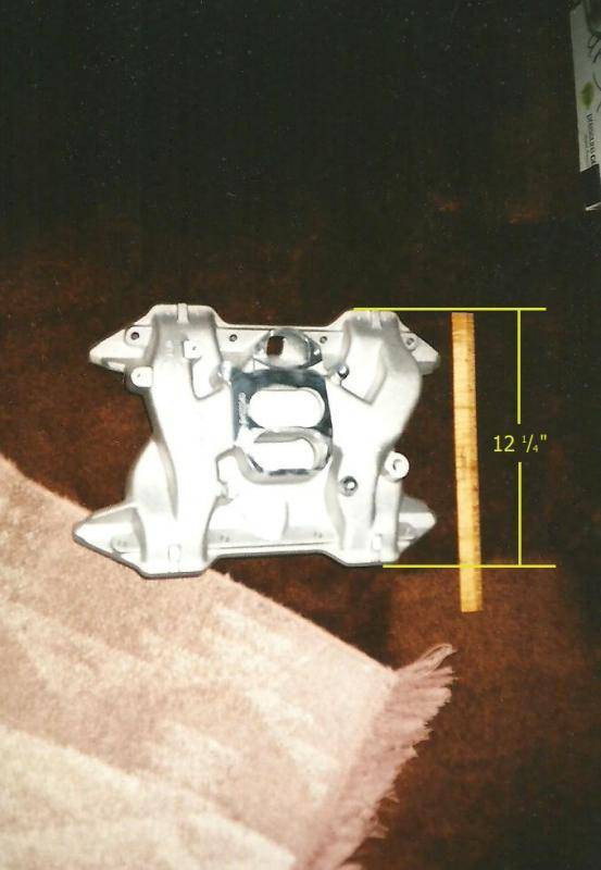

Here's an old pic of my Mopar M1 Intake Manifold. This one fits the B Engine (383 & 400 cid) Big Blocks. Sorry the pic is analog, but the width at the top edge of the mounting surface is approximately 12 1/4" as shown. A manifold for an RB engine should be around 1" or more wider than this. I hope this helps.

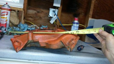

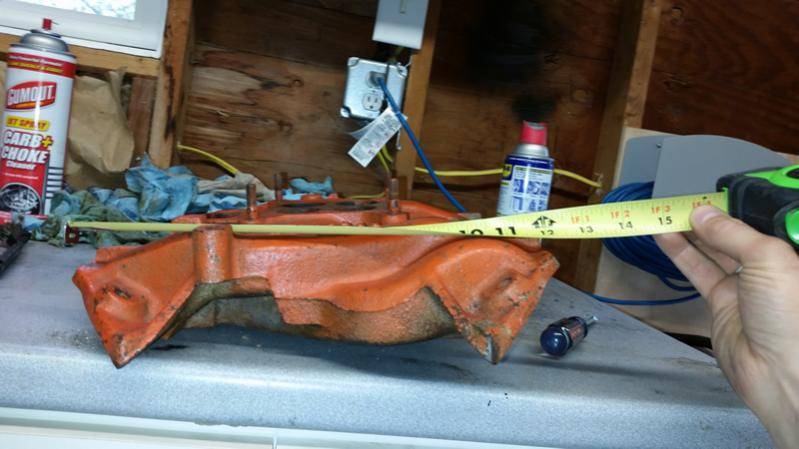

I measured my 383 and 440 (both '68s).
It was easier for me to measure distance from inside the points rather than the bolt holes so my measurements may not match what someone else has.
Using your pic, you can see where exactly I measured.
The 383 was approx 6 3/4 inch
The 440 was approx 8 inch

Mine measures 12-1/4" just like Wildaugust shows. I was able to find some casting numbers on the block under the exhaust manifolds. I assume the same number is on both sides? It was hard for me to get to the pass. side so I got some #'s there and the rest on the drivers side. Here's what I have now

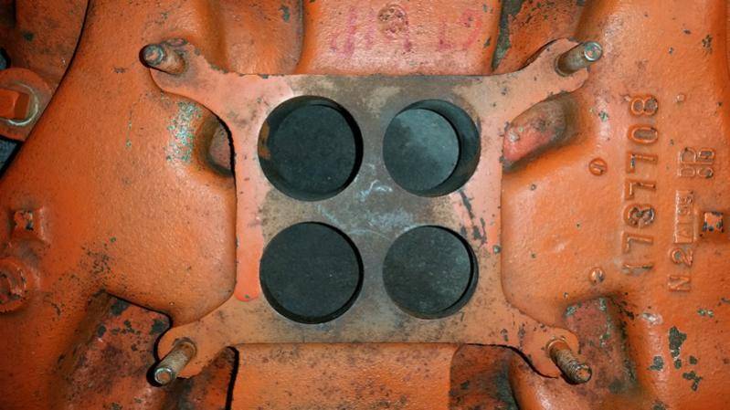

Free intake cast - 1737708
From what I can see after measuring again today, this time more accurately and using the same points of measuring as shown by you guys above, Both of my intakes are the same. I also realize that I am no expert and that I should be wrong, but I just don't see where, lol.

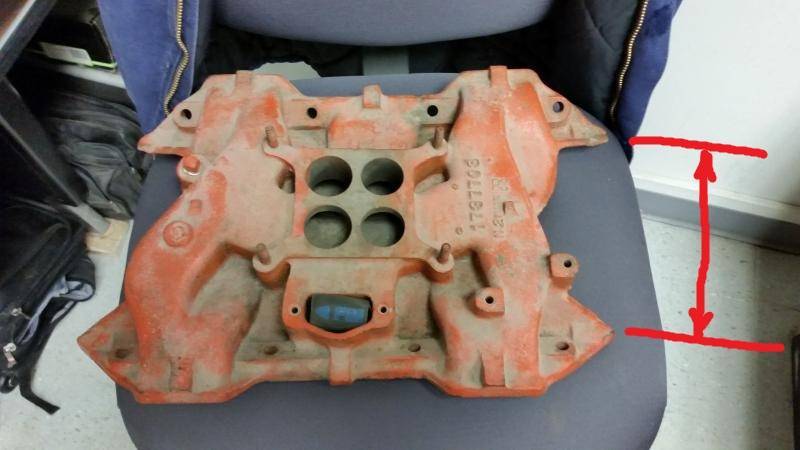

Since some of you were talking about the intake holes, here's an overhead shot of mine (freebie intake). The front two DO measure smaller than the rear. Plus a pic of me measuring the width. (just cuz we all like pics)freeintake3.jpgfreeintake2.jpg
Bluefury36, you posted a link to fowardlook that shows the same number intake, but that one has holes/spaces between the tunnels, where as mine is one solid piece. Not sure if that means anything..
Also, on my freebie, there is red marker pen, barely legible in the pic, but at some point someone wrote on it - 67 383 VIP. if that helps?

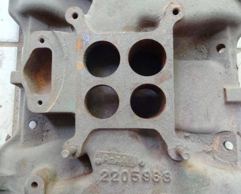

I see what you mean about the open area between the runners. I don't think that will effect anything. Now i'm curious about the cast date on your manifold. In 1959 the B series manifolds went to the larger carb mount base with the change from the WCFB to the AFB carters.
I have a 4bbl intake number 2205968, used on 1962 to 1966 361 and 383's. It has the closed area between the runners like yours and has the same carb mount base. My guess is that your manifold is a 1959 to 1961 engineering upgrade of the early manifold. The "N2" below the cast number may verify this.
The choke mount pad seems a little different also.
