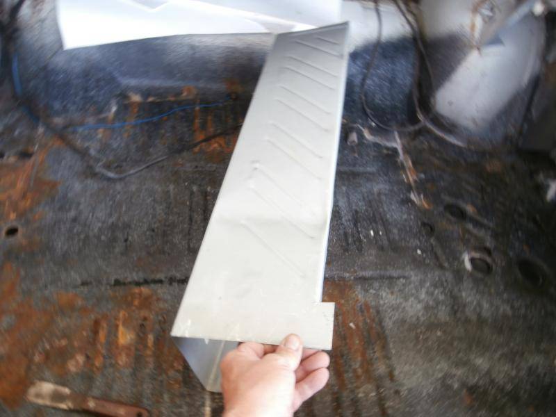

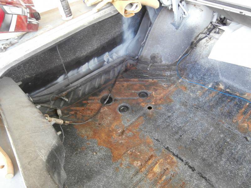

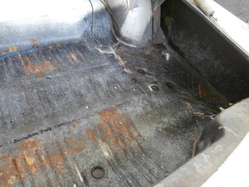

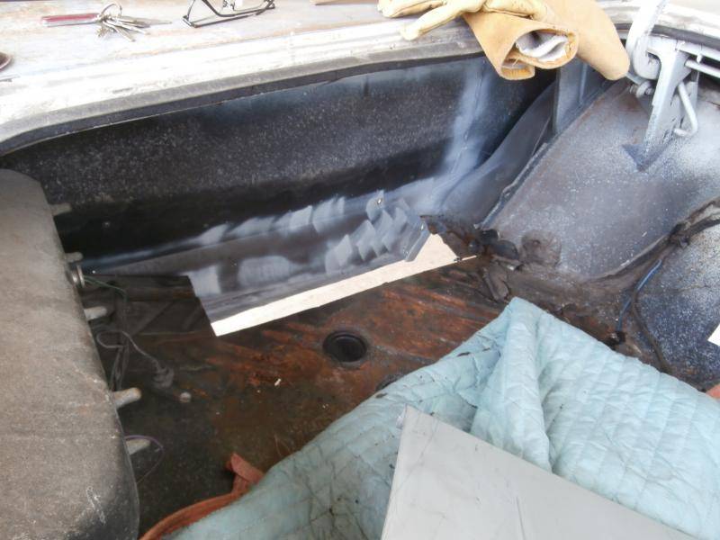

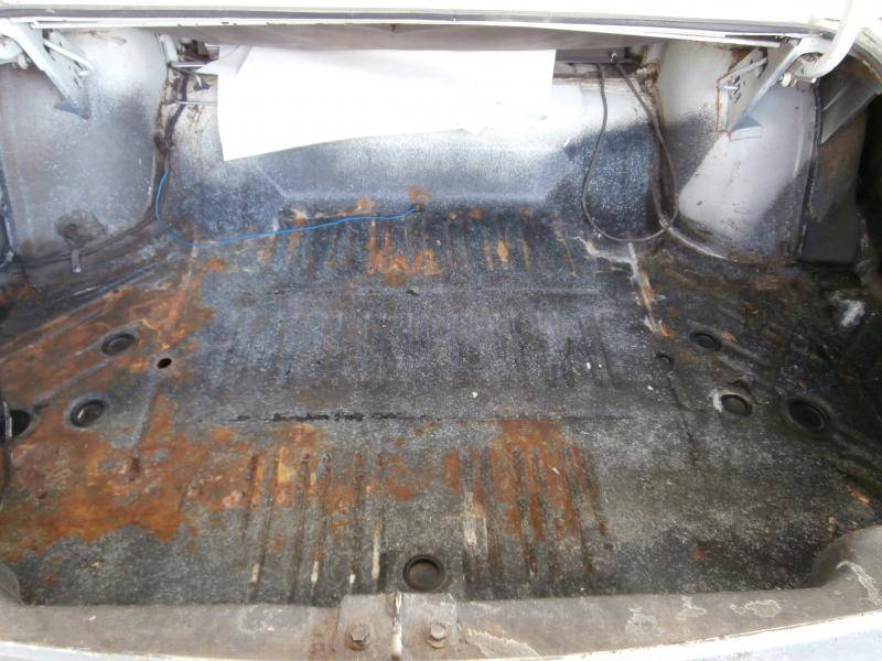

I worked on the convertible last weekend. car and table 020.jpgcar and table 021.jpgcar and table 022.jpgcar and table 024.jpgcar and table 025.jpg

Lol! What were you thinking, or were you thinking???
That's the spirit.
My attitude when I F/#@ up is that I F/#2ed before and I will F%#@ again. Move on. ☺
Exactly Stan. I didn't realize how bad the trunk extension was until I pulled up the pad. Not a biggie. I'll just have to finish it when I retire. Five to eight years.
Before you do anything you need to position your jackstands in the proper place, under the differential. Where they are now can cause the body to sag. Especially on a convertible. After all your hard work you don't want warpage when you set her back on all four! Good luck! o
