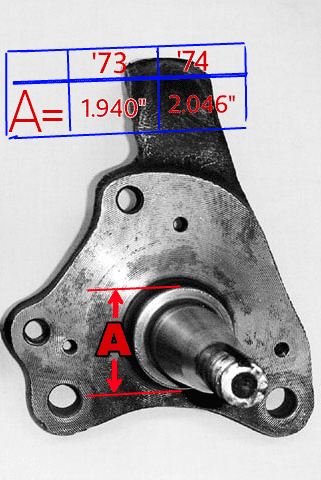

Is this what you mean by "spindle diameter"?
Thank You for the responses. I should have been more clear. The part where the wheel bearing goes on the spindle shaft is different from the 69 to 72 spindles compared to the 73’s. From what I hear the earlier ones were smaller than then the 73’s. I made the switch 8-10 years ago and I can’t recall which ones I put on. I haven’t had the wheel off since and now I’m ready to buy the rotors,calipers etc. and I just need to know what size spindle I have before buying. Thanx again,Mike
That's exactly what I was referring to. I couldn't understand any other dimension he was referring to seeing as the "spindle" is tapered.
Got it.
It is likely the machined inner spindle diameter and the outer diameter just after the threads where the bearings sit that are also the main difference that combine to make the total differences for each year

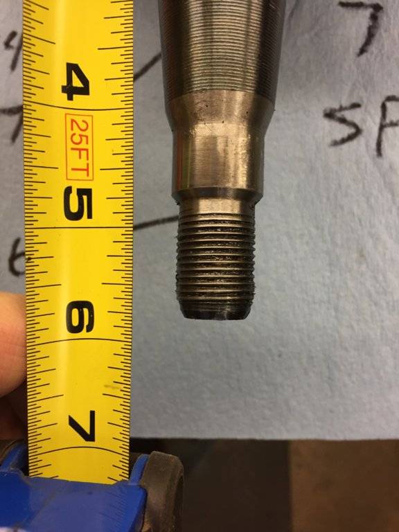

It’s 5 7/8” in length
Thank You Mr. Fix It, Those are the numbers i’ve been looking for especially the 1.375 number for the bearing race.I understand the 73’s were a little bit bigger than the 70 to 72’s.I know somebody posted the 2 sizes of the different years but I cannot seem to find it. So much great info.Thank You to everyone for responding.
