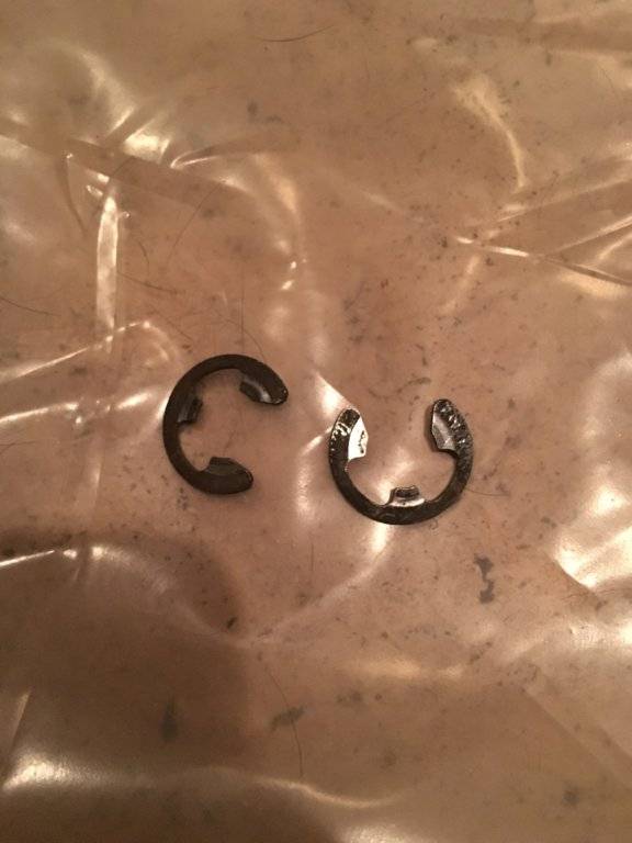

Do these C-clips go on the inner side post of the 70 SF headlight doors? Do they go before those V clips or after?
Also any tips how to get them on, if so? I can’t get them on for the life of me.

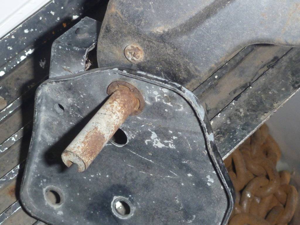

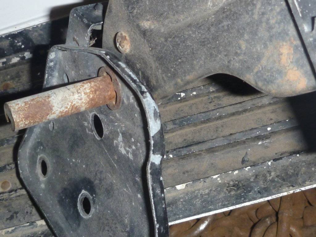

Ok I think the C clips do go on the door rods. The V clips hold the motor rod in place.
I have a collection of doors uncleaned and crappy but you'll get the idea. Give me a shout if you need better pictures.
View attachment 149227 View attachment 149228

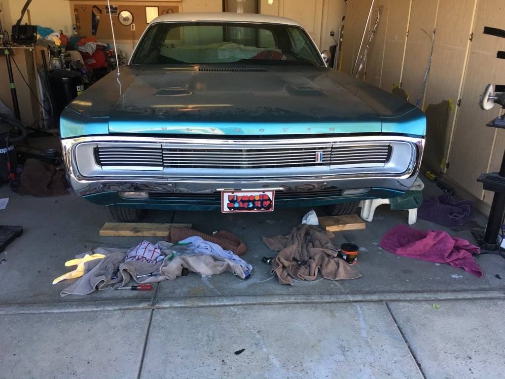

Well at least the bumper and valance is on. Needs some adjustments but I’ll get there eventually.
