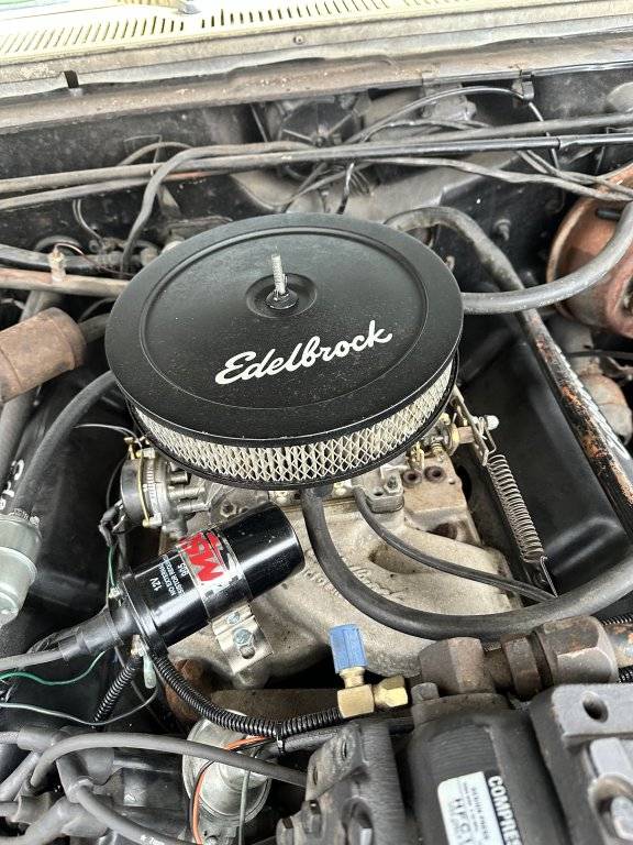

Hey friends, it seems that after a one-hour drive, my engine is pretty warm. It starts to sputter and then cuts off while idle but turns right back on. I’m unsure if it’s a fuel problem or an air filter. My air filter is not that dirty, so I did check that the fuel filter Looks good. Do you have Any ideas on what it could be?

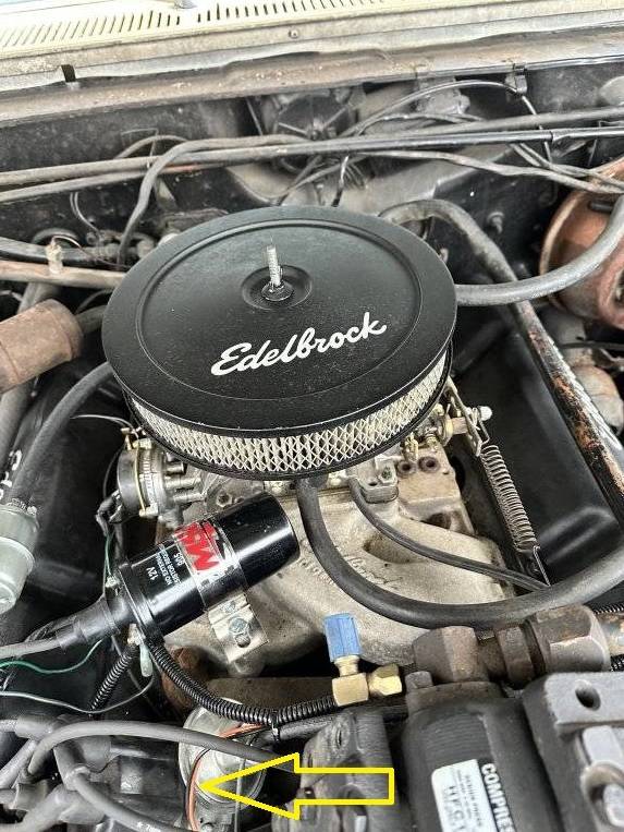

Based on these two wires (yellow arrow), I'll bet it's a Mopar electronic ignition. If so, this is a good thing.
Look around under the hood and see if there is a piece like this (may be a different color). If so, the car has been converted to electronic ignition and this is a good thing.
Here's the issue... Most of the problems that are blamed on the carburetor are actually problems with the ignition and that's why these guys are approaching it from that direction. I can tell you it's not going to be the air filter.
You'll have to be more descriptive with what is going on though. The type of ignition is huge here. You also need to say what engine and what exactly happens. We can see it's a big block (distributor in front), automatic (carb to trans linkage) and we can see an aftermarket Edelbrock carb on an Edelbrock manifold, but that's it.
When you say it dies at idle, do you mean the car is sitting, let's say at a traffic light and it sputters and stops then? Or is it when you let off the gas to coast, like coming up to a traffic light? It could be as simple as turning the idle speed up a bit... It could also be ignition timing.. By any chance is the AC running when this happens?
The fact that it restarts easily (from your description) points towards it not being a fuel delivery problem or a problem with excessive heat on the carb. It still could be a carb issue, float level comes to mind here.
