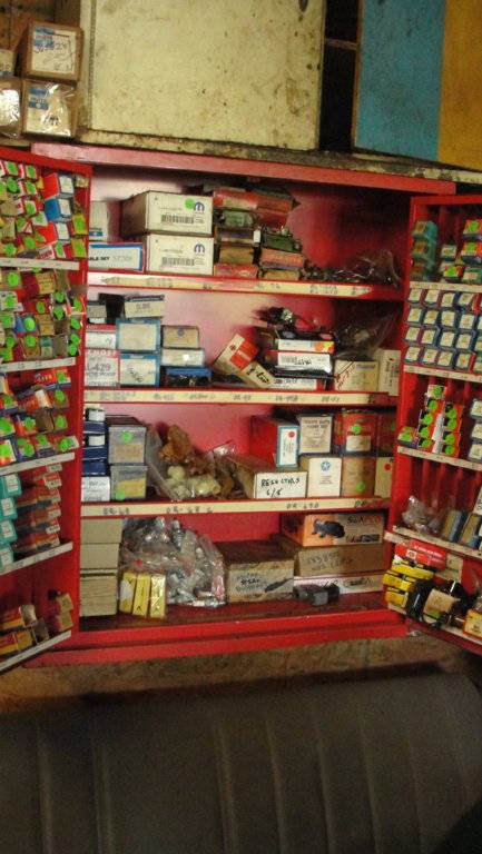

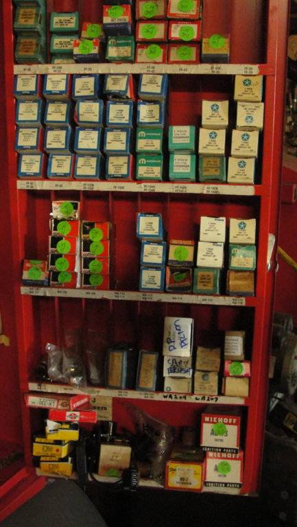

View attachment 323052 View attachment 323053
Sure thing. 50 yrs ago, the factories AND workers in them were in prime condition. Quality control excelled corporate beancounter moneylust. That began to tilt toward today's disgusting imbalance during the late 1970s, when Mopar killed the C body as one example. My headlights, points, condensers all were made during the Age of Golden Detroit Iron and will be the ONLY stuff I install when available. I look forward to running one of your distributors. Let's see how the $$ rolls in this Fall.
