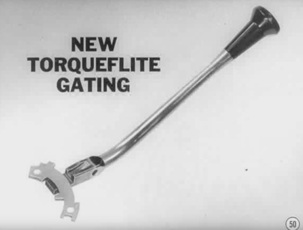

No adjustment. A "gate" is screwed onto the inner section of the shift bowl on the column. If lakd flat, it is a long rectangular piece of meta, maybe 2" long by 3/8" wide? With a curve so it will match the shift bowl's area where it is mounted.
From P, pull lever toward the driver and then move it down to R, which will let the lever move a bit forward at the same time. Then more forward as it is moved to N, with the same orientation for D, where it stops. The pull forward a bit for "2" and a bit more for"1".

From a '67 master tech video:
there should be a spring in there that pushes against the base of the lever...i've seen a couple of them break...or a broken one may have been replaced by something weaker and wont hold the lever against the detents
Can the arm and spring be removed and reinstalled from the bowl without having to take the bowl off the column?
