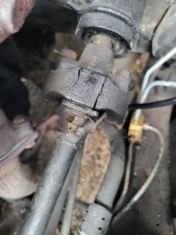

Are these rubber steering coupler/Rag joints a big deal to change? If not wheres a good place to find one?. Thanks
You didn't say what year or model. Assuming it's a late 60's/early 70's C body, buy a Lares 220. Rock Auto has them.

Thanks. I understand there was a steel cover over these Rag joints. Any idea where to locate one ? Thanks

That is correct.
No one I know of makes a reproduction, so you have to find used. Put an ad in the wanted section.
Do you need hardware when you change joint ? Also do you have to take off shaft. ?
Thanks never done one
Yes, disconnect the wring at the plug under the column. Remove the spring pin on the coupler, the bolts holding the plate to the floor and the 3 nuts holding the shaft up.
The shaft should then separate at the lower coupler from the steering box and slide off the spline.
I don't have a great pic of mine, but this should give you an idea of what comes out of the car.
Note the master spline on the coupler. You'll need to align that when it goes back together.
I suggest you mark how it came apart so you don't end up with an upside down steering wheel after.
I did mine this summer without pulling the column out.
Loosen the 4 bolts that go into the "hockey puck"
Undo the bolts on the floor inside the car that hold the sort of triangle piece at the base of the column where it goes through the floor.
Sit in the drivers seat and pull on the steering wheel, it only needs to come out a little bit (maybe 1/4-1/2")
That should give you enough slack to remove the "hockey puck" and install the new one.
With the "hockey puck" out there should be enough room to pull the lower part of the shaft out and rebuild or at least re grease the lower coupler. (The square metal one connected to the steering box)
Good news is a '65 should have a bolt head screw holding that coupler on rather than the roll pin that has to be driven out like the later cars have.
