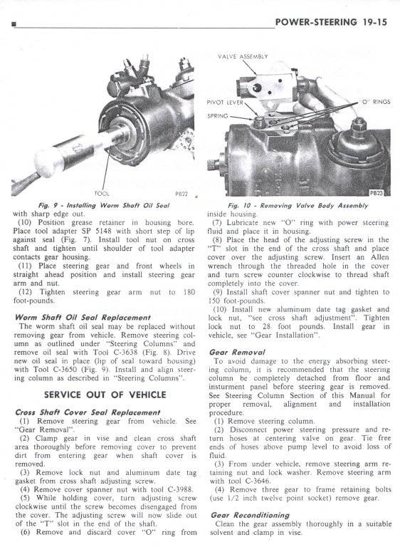

1971 FSM calls the Leaking Seal, the Cross Shaft Cover Seal. Factory procedure for 1971 is to remove the steering gear, with possibly the main reason being not getting dirt into the gear. This should give you an idea of what's involved. Best of Luck!
Perfect. I did order a cd drive just so I can read my fsm. This diagram should help. Thanks
Grab a '68 Plymouth version for now off Service Manuals – MyMopar For this, it's going to be the same as your Chrysler FSM.
And... I gotta ask this... Are you sure it's leaking from there? That area collects oils and fluids from leaking pumps, valve covers, and especially that return hose right above it.
Just trying to keep you from any more work than you need to.
