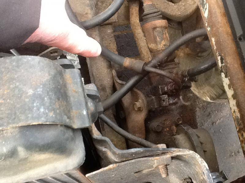

Hi guys can anybody tell me what's the pipe called on the steering gearbox it sits at the top it's a right angle pipe with a big nut and thers a hose attached to it going to the power steering pump it seems to be leaking at the nut on the gearbox I have tried to tighten it with no effect there nothing in my manual to tell me what the pipes called 1987 dodge w150 pick up ps I think it maybe a pressure pipe:BangHead:

Yes looked at my post disgusting spelling of the English language . I haven't been to school for over 50 yrs . And not wearing my glasses doesent help "lol" Back to my post there is a small right angle pipe at the top of the steering box . With a nut which is leaking . And that in turn is connected to the power steering pump via a rubber hose . I just need to know what the angle pipe is called so I can order one as it doesent show up on my manual
It's a return hose. If it's held on by clamps. The other one screws into both the pump and gear box that's your pressure hose.
I just had a look it's not a seperate angle pipe as I thought its one sealed rubber hose with metal pipes at both ends secured to the gear box by a nut and to the pump by another nut the second pipe next to that with the rubber hose is connected by jubilee clips so I think your right that's the pressure hose
Yep. It gets replaced as an assembly.
