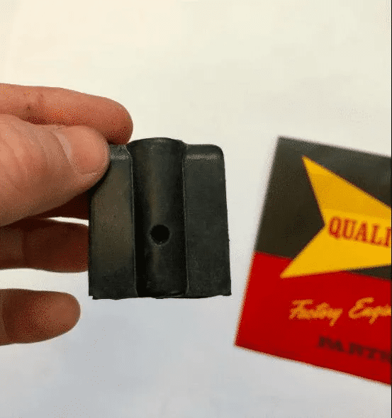

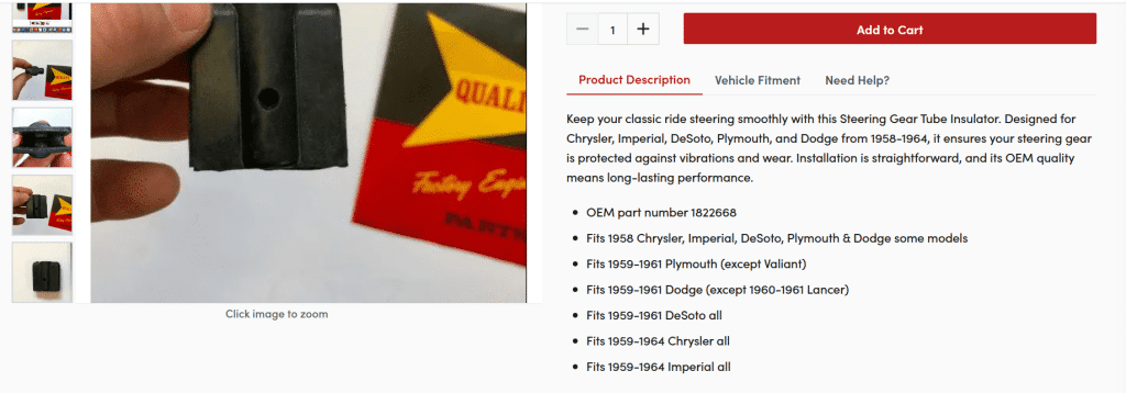

While looking for various replacement rubber parts for my '63, I came across this: Steering Gear Tube Insulator | 1958-1964 Mopar Cars | Andy Bernbaum Auto Parts
My car came from the Southwest, and a lot of my rubber bits aren't great as a result. I probably should replace this, and it's not expensive. The listing says installation is "straightforward". I just can't figure out where it goes! I have a factory manual, but even the section on the steering gear doesn't seem to explain this part. It's one of those times the manual just kind of assumes anyone reading would know.
I'd love any advice, and especially pictures!

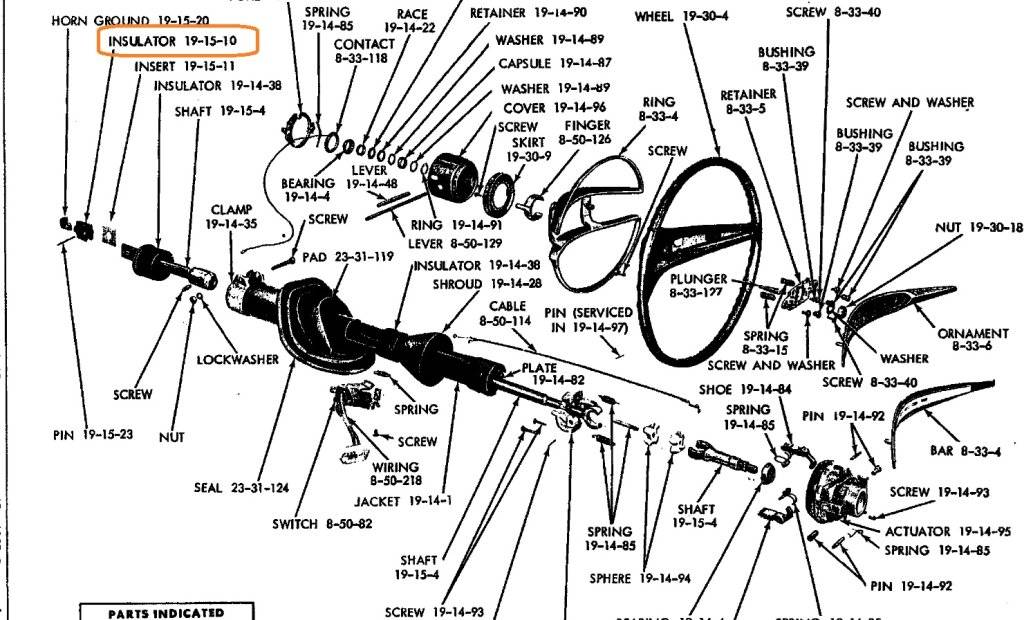

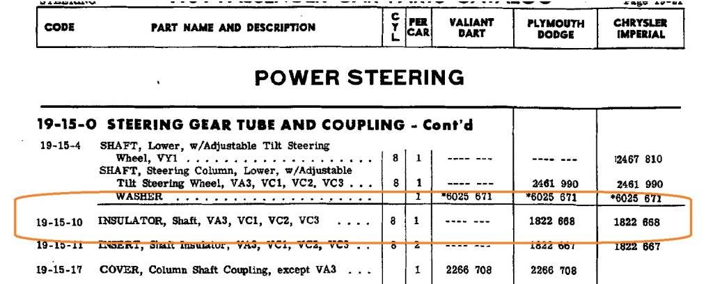

Per the ad, OEM part number is 1822668
Look up the part number in 1964 parts book showing illustration is 19-15-10.
Now to 19-15-10 and that gives you a pretty good idea where it goes.

The parts illustration if from the Parts Manual, not the Factory Service Manual. As is the part number listing.
CBODY67
Not a fun job to replace that. It goes on the end of the steering shaft where it enters the steering box. Must remove the outer column housing in the car. Many possibly snags along the way. Does your horn work now? It may not after the surgery.
