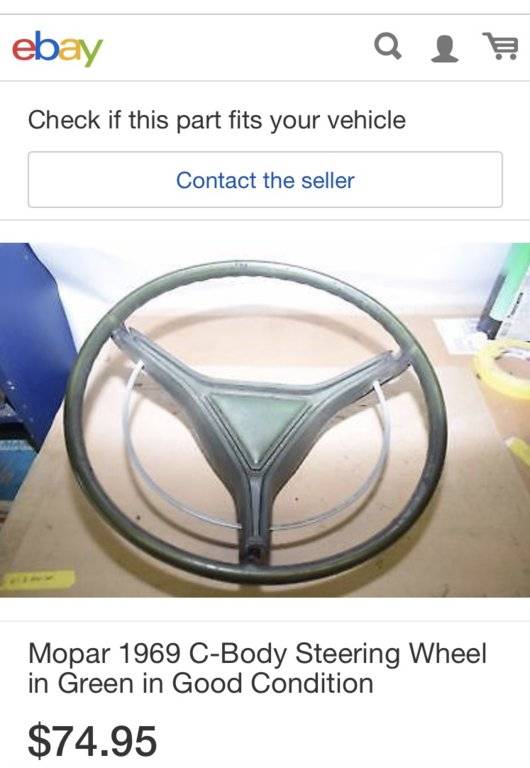

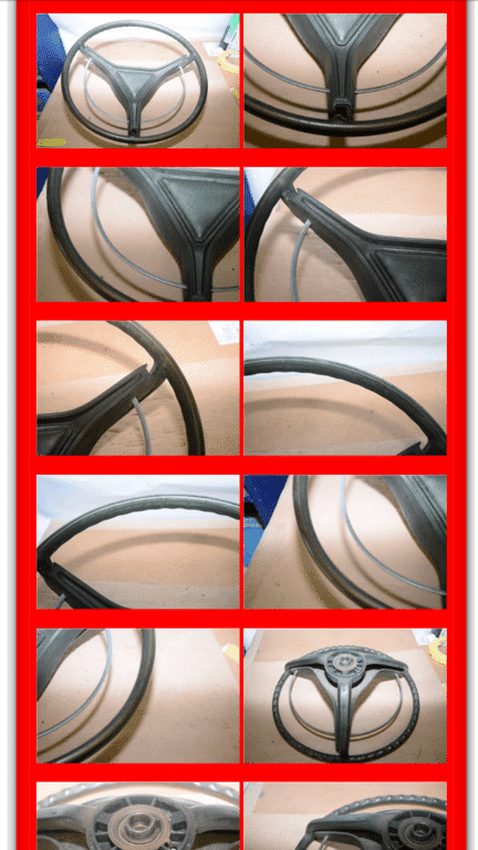

Ok guys. For a little more than the cost of a leather wrap I scored a nice replacement wheel. No cracks warts etc etc only problem is it's green. I've painted just about anything you can paint on a car to make it new looking even carpet ( it works!!! ), but I've never painted a steering wheel.
After a few bidding wars ( they upped the price in person ), I'm now understanding a cheap woodgrain is going to take a while to find so I'd like this paint to last.
What's the best way paint this sucker. Do I sand it smooth but not to bare plastic or sand all the paint off and use some magic plastic paint??? I'm thinking maybe radiator paint cause it's crazy strong. I don't know, point me in the right direction please. Im just afraid of winding up with a sticky wheel. the color it needs to be is glossy black.

Thanks guys. I'm kinda spinning my wheels until it shows up. I'm just thinking if that ancient paint is good under all that mung a good light sanding ( not all the way thru it ) might do the trick. If the old stuff shatters after I add new paint. I'll take it down to bare plastic. If that sound like a recipe for disaster somebody stop me.
The wheel is molded in that color.
I would clean it well, rough it up with some scotch brite and epoxy prime then paint and clear.... Lots of clear...
I would paint the center with SEM paint for plastic. Clean with SEM soap and use their adhesion promoter. Follow their directions to the letter. I did mine that way a couple years ago and it still looks great.
You could try using the SEM paint on the wheel too... But I think the coating will wear through.
I removed the leather wrap from my wheel in my Barracuda and expected to find that it was put on to cover up cracks... I was more than pleasantly surprised when the wheel was almost perfect under the leather.
As stated above, the wheels are cast using colored resins. In my experience, almost all painted wheels chip over time. Your best bet for longevity is to have the wheel recast. The resins they use today are superior in every way to what was used 40+ years ago. I don't mean to burst your bubble, but the wheel you purchased will almost certainly crack at some point. I had my wheel and shift ball recast in the correct color and they are guaranteed to not fade, shrink, crack or chip for as long as I own the car. Quality Restorations in Poway, CA did the work on my wheel and shift ball. qualityrestorations.com/

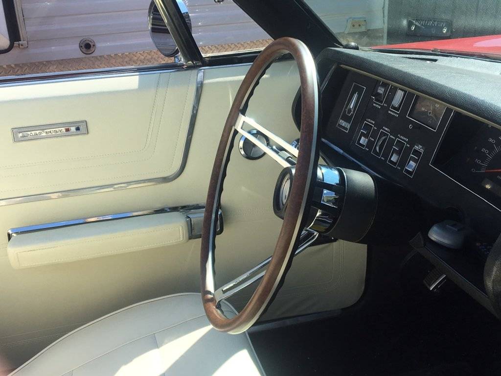

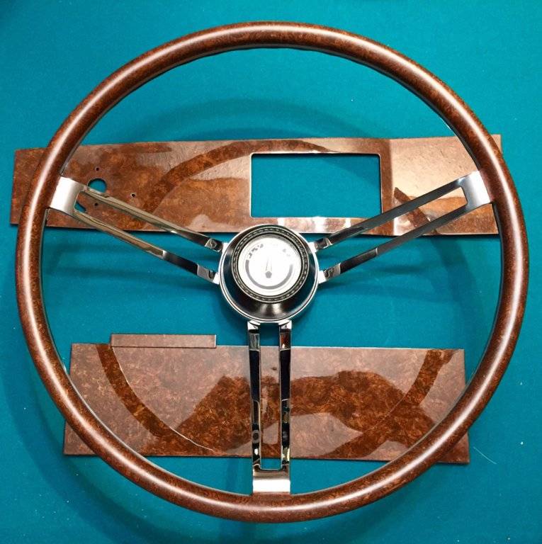

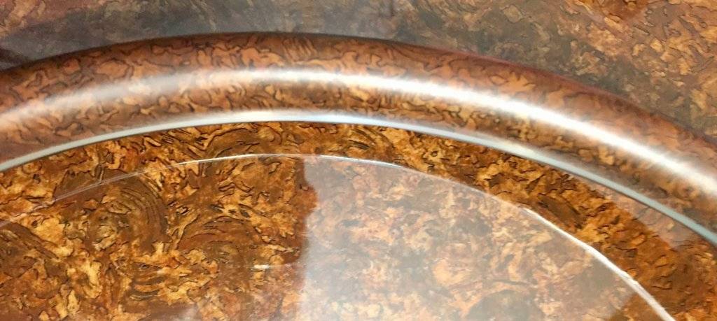

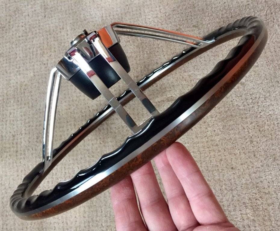

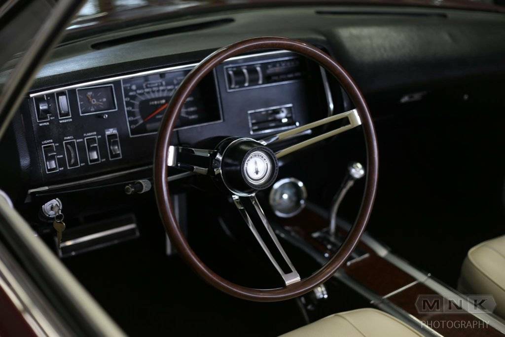

The steering wheel guy Doug Lepak is the go too guy. He did my wheel, he does amazing work. If you can check him out on Facebook. That’s Doug in the first picture
I love that style wheel.
I think they call it the "recall" wheel because of the spokes are thin and can stab you in a crash.

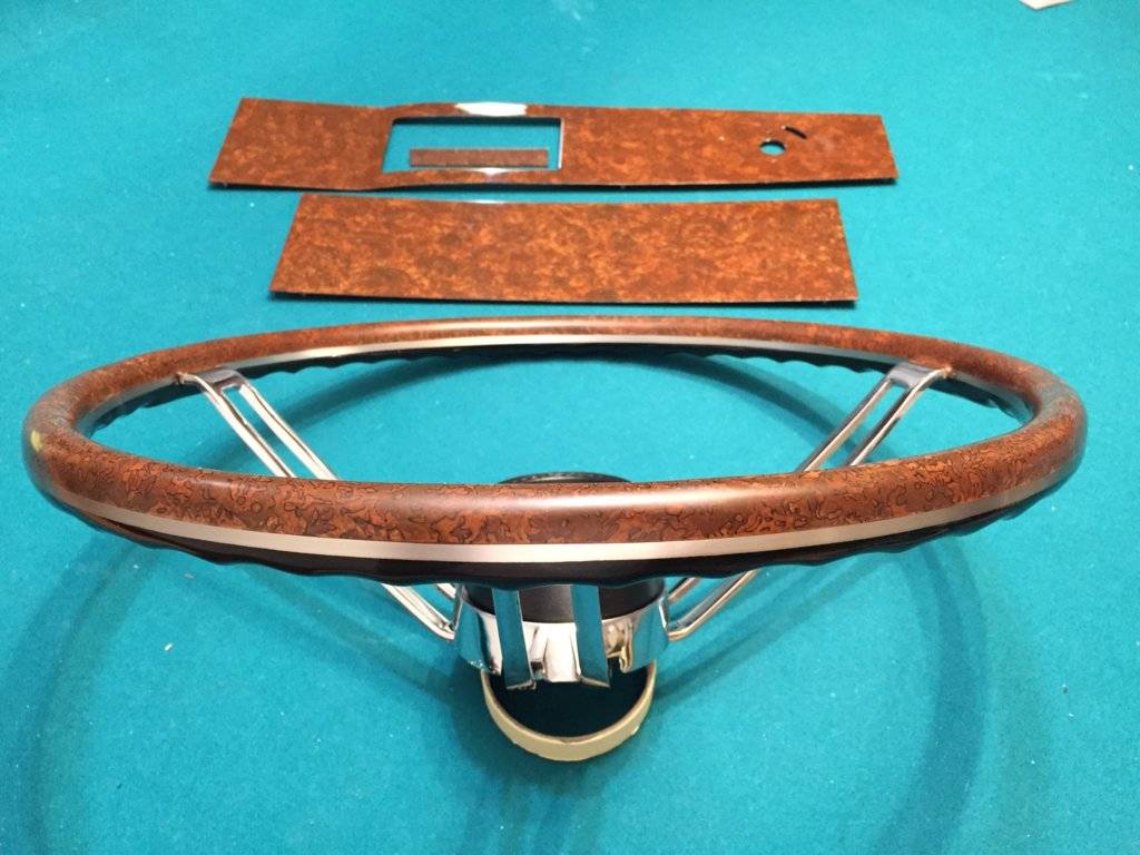

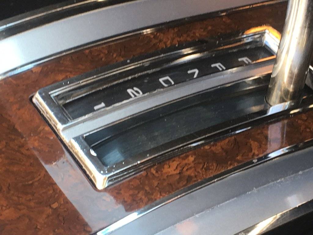

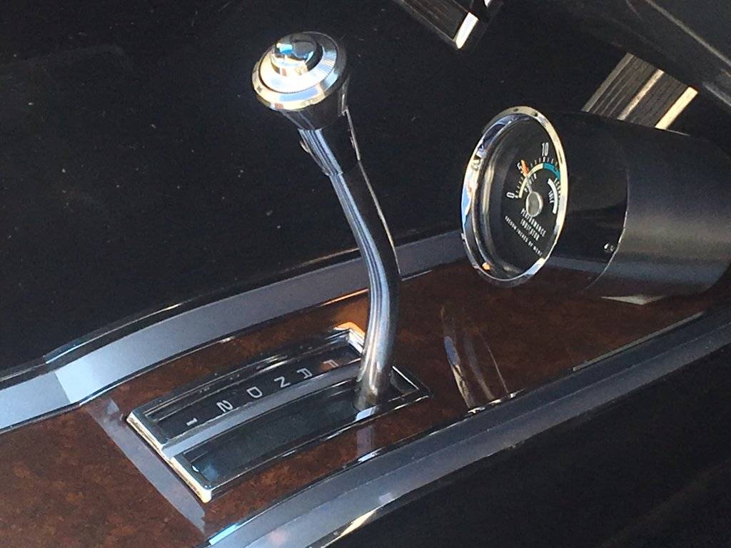

yes it is. I had Doug make it a 2 tone Wood grain and black separated by the original stainless steel ring then had the console trim painted to match

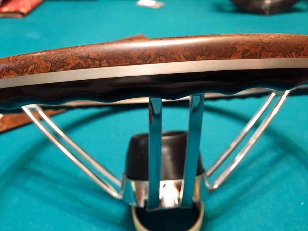

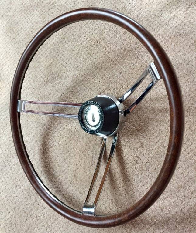

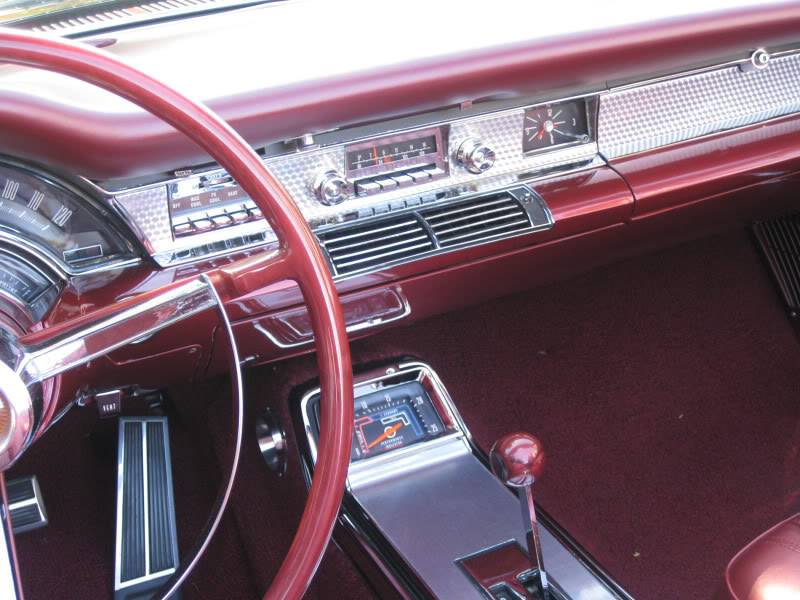

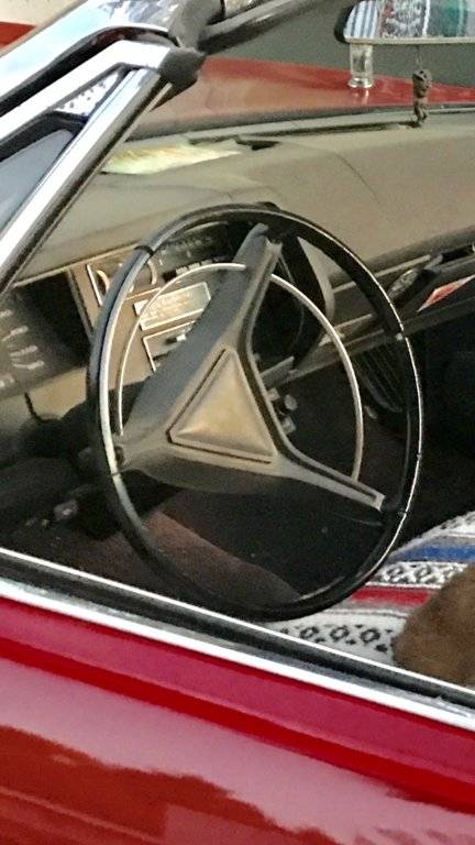

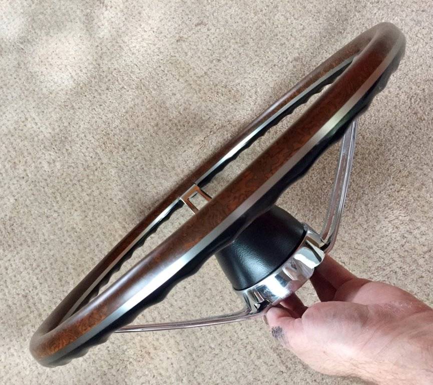

Here’s a couple of pictures of the wheel in my car. The spokes were rechromed as part of the restoration process
View attachment 171305 View attachment 171306 View attachment 171307 View attachment 171308 View attachment 171309 View attachment 171310 View attachment 171311 View attachment 171312 View attachment 171313 View attachment 171314 The steering wheel guy Doug Lepak is the go too guy. He did my wheel, he does amazing work. If you can check him out on Facebook. That’s Doug in the first picture
