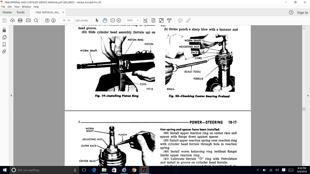

I am having an issue with the steering. The car is not running yet. The steering worked before, when I first saw the car. At some point during the shipping from New Mexico to North Carolina the steering got messed up. Basically, when I turn the wheel you can hear teeth somewhere in the steering column slipping. I am trying to take it apart, but can't even get the steering wheel off. I got an old factory manual, and it says you need a Tool C-3428A to remove it. Anybody got a work around on this?
