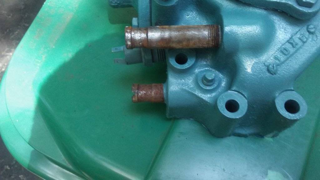

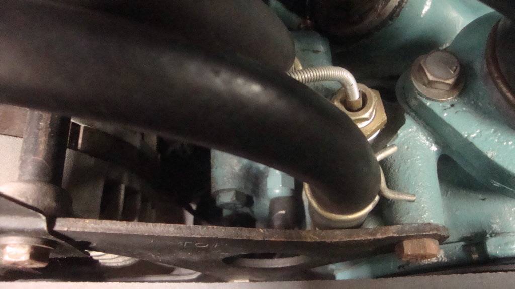

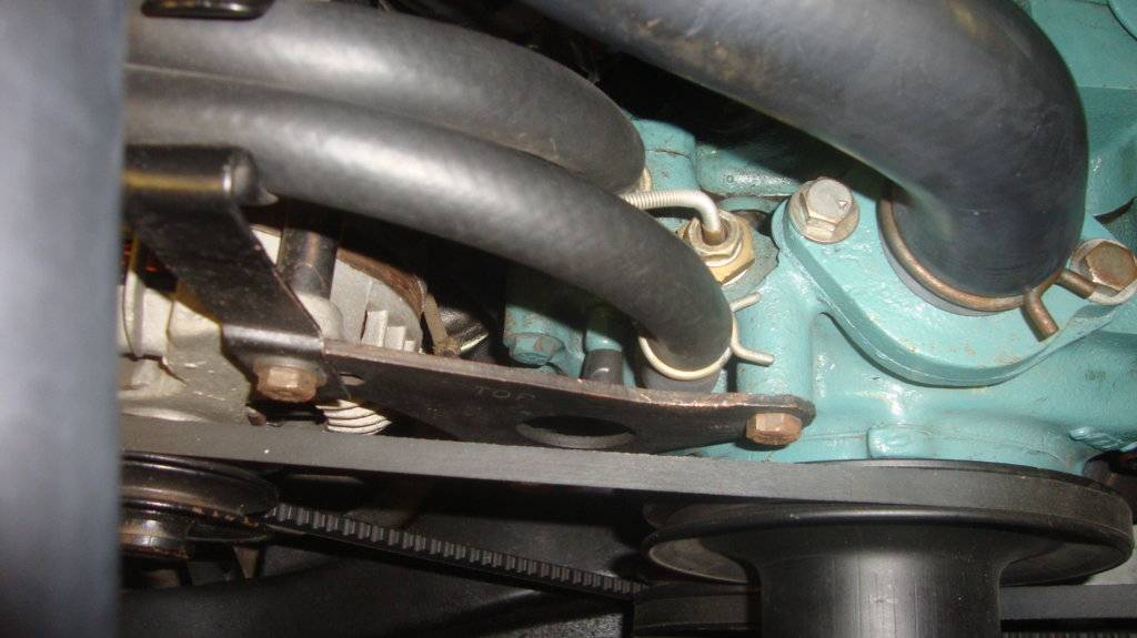

MarPar...your pic shows where my OEM sender is now...right? Maybe I missed something. If you have more pics, that would be greatly apprecitated! ThankS!!
No Sir. If i remember correctly, I put the secondary gauge in my pic. The OEM plug is just above it.
I will take a clear pic of my water pump...standby.
Time flies!! lol
Closeup pics...I hope they help!
Brass plug is aftermarket gauge (installed by me), rubber boot is oem (I reckon).
Now I see! Thanks!! That's what mine looks like. I have that same bracket, plug is buried in there somewhere. I'll break out the flashlight in the morning and take a better look. Thanks again, pics speak a 1000 words!!

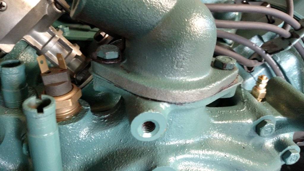

I think I found the place to install the sensor for my AutoMeter temperature gauge. Looks like I can have both the idiot light and the gauge. I discovered a little plug I was able to remove, and the sensor for the gauge screwed right in it's place. Here it is on the right with the original large two-prong sensor on the left:
I don't have a plug/hole where that smaller brass fitting is to the right on the top next to the thermostat area. I saw that area in another thread somewhere. I'll double check in a bit. Watchin' NASCAR now lol.

I'm going to have to go back and look at mine. I installed a "t" even though I didn't want too. I'm fairly sure that I don't have the port that is on top of the pump underneath where the AC compressor would be. I'll be looking for the one over by the heater hoses.
John: If you have a 440 or a 383 in your car, its there. It takes a 9/32 mini socket.

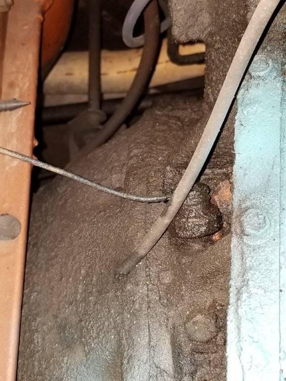

Thankfully Pep Boys is having a sale on chemicals! Gunk 2 for 7 bucks, also Brake Clean is 2 for 7 bucks! Stocked up!!! Used two cans of Gunk, can actually see the plug now, nice and clean at rear of block! Still could use more scrubbing, but hard to reach all areas. Always get nervous when starting a old car after spraying water all over motor. She started right up. Didn't spray directly on distributor cap or any electronics.
Sensors showed up today. Will install those Tuesday after work. Off Wednesday, should be able to get a lot done that day.
