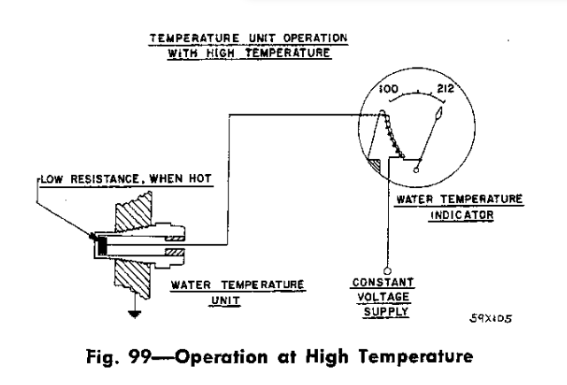

The shop manual contains this picture, but I think it may just be generic, because the actual gauge doesn't look anything like that. The 1963 owner's manual isn't much help, either. It just says "shut the car off if the needle goes all the way to H", otherwise any reading is acceptable. (It's almost like they knew the gauge was nearly useless!)
