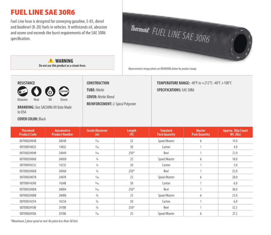

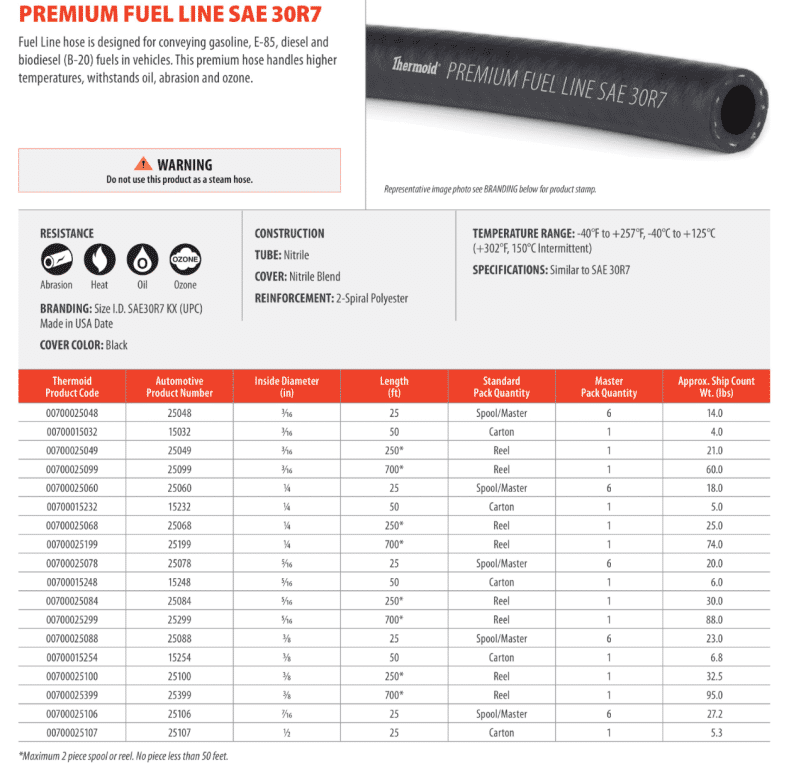

Fuel injection hose, SAE specification 30R9, works, but Thermoid makes the conventional Nitrile based hose, SAE specification 30R6 and 30R7, that can handle ethanol bearing gasoline blends, including E85.
The following images show the Thermoid catalog listing for these hoses:
