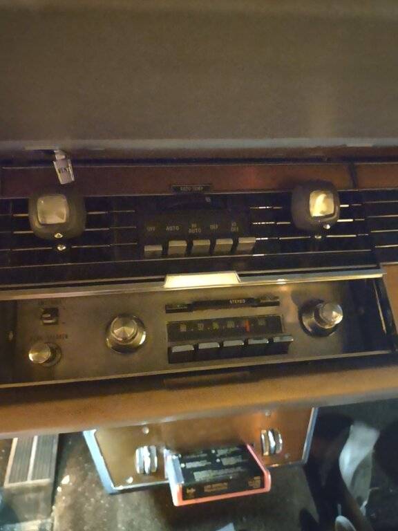

The radio in my '68 Imperial is acting strange. It will turn on and after 5-6 minutes or so, will quickly fade out, hearing no sound. Sometimes turning it off and waiting a bit will get it to turn back on, only to do the same thing again. Before that during the summer, I noticed that the radio at times would completely fade out while coming to a stop, then return to normal when moving again. Any idea what might be causing this?
Might be something in there that is having a time/heat/voltage-related issue, due to its age? Something which just started or might be related to the cooler season now starting? AM, AM/FM search tuner, or AM/FM Multiplex, or 8-Track tape? Tayman can add some upgrades for Bluetooth and such, if desired.
Just some thoughts,
CBODY67
The radio is an AM/FM Multiplex with reverberator. It also has the factory optional 8-track player mounted underneath the dash. The 8-track player works as it should.

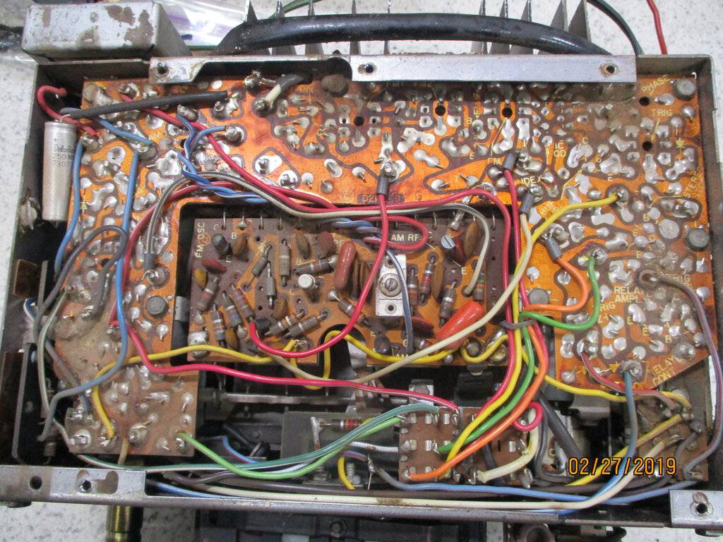

My best advice is to not waste too much time or any money on repair.
Just find the bad solder joint and resolder it.....or the bad resistor or the bad transistor or the bad capacitor. No problem at all!!

Most likely the problem is in the radio with the Germanium transitors. That type of transistor is no longer available and you can't simply substitute a modern silicon transistor into the circuit.

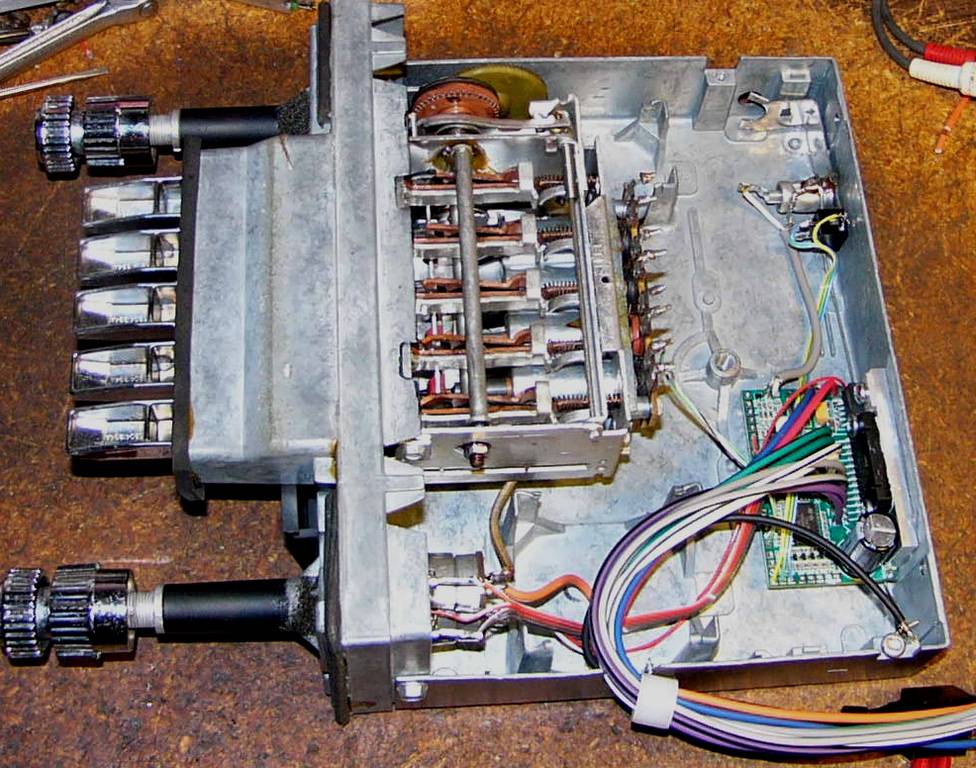

My concern about ‘modern’ conversions is the signal to noise ratio and abilities to pick up a radio station are poor compared to old radios.
Have those that have Tayman’s products experienced this?
I gave up on commercial radio after spending so much time in the car for work, so I can't really address this as well as others that have used the Aurora conversion. I use my Satellite radio all the time and the conversion works out great.
What little I have listened to the am and fm bands, the reception and sound seem good.
I did find some specs for you though.
FMR AM/FM radio | Aurora Design
BTW, I knew the design was developed in the USA, but I figured it went overseas when production ramped up. In researching this, I'm glad to see that this is built in the USA!

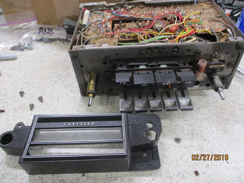

Please tell me this is a prototype!! lol
Nope, it's the AM/FM from my 70 Hurst. Damn thing weighs at least 8 pounds, and everything on it is sharp as hell when you're removing it from the dash, ESPECIALLY the heatsink on the back of it. Awful....
