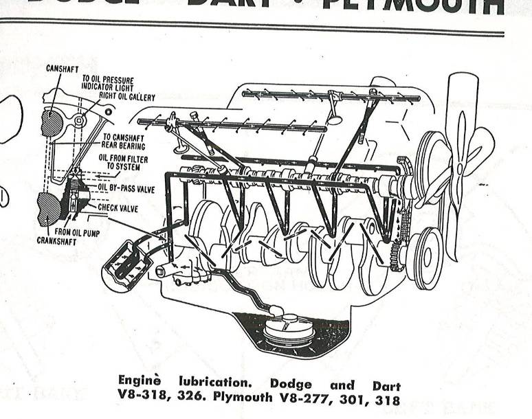

What I was trying to say is best shown in this diagram. The oil passes thru a hole at each end of the cam and goes up to the rocker shaft. Note the location of the oil hole in the rocker shaft and what would happen if the rocker shaft assemblies were accidently reversed.
That diagram is wrong or the poly engines are different( I'm not 100% on them). The LA and BB feed both sides off the passage from number 4 cam bearing. The heads and the rocker shafts are universal with the passage in 2 places in each head and at the same bolt holes which are enlarged to allow oil to pass by the bolt and into the shaft.
Very probably there are lots of different designs. I ran into this probledm and I am just suggesting he needs to check it out if the rockers are running dry.
