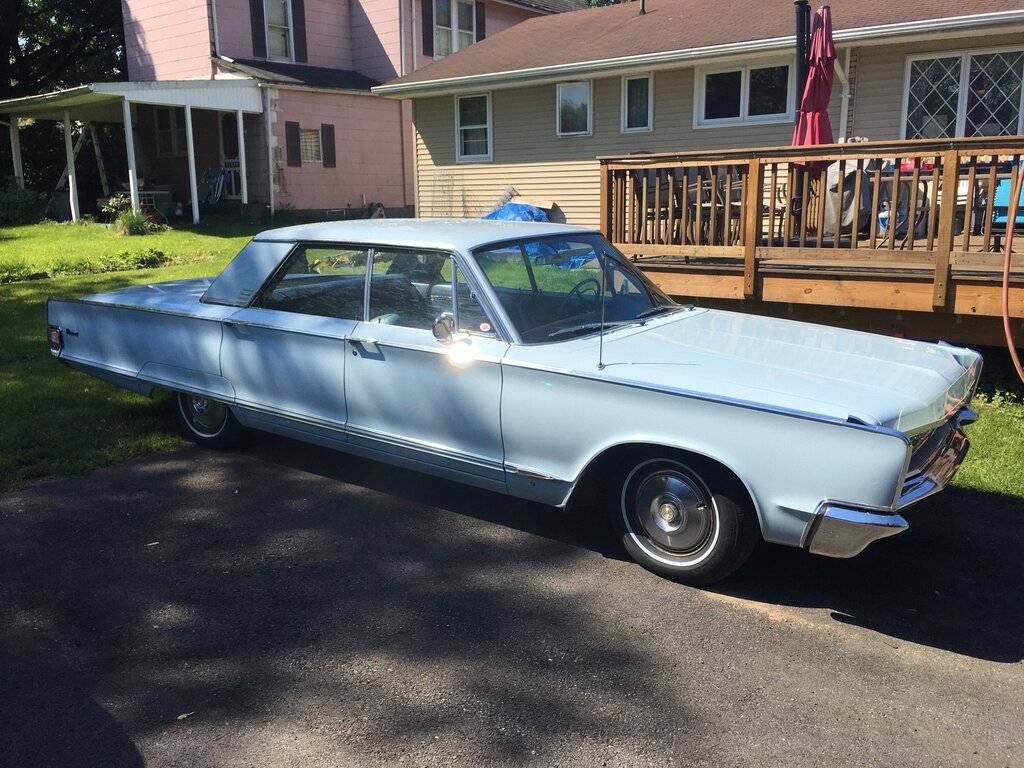

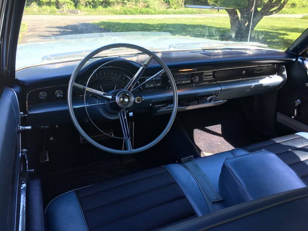

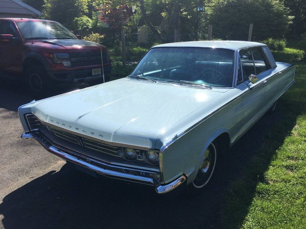

So I hope you guys don't mind me trying to get some info here. I have a 1966 Chrysler Newport 383 2bbl with a Bendix-Stromberg WWC Carburetor. I just got the car a month ago and the car sputters and occasionally back fires through the carb. I have ordered a rebuild kit. I worked on these cars 40 years ago, but have not touched a carb in 35 years or so. Any advice???
Thank you! I replaced the plugs, wires, cap and rotor the day I picked it up and drove it 900 miles home from Wisconsin, but am not crazy about th edesign of the 3 plug wires on the odd-side that run down through the engine gap backside to the PS pump. I feel thats an invitation for jumping the spark. I intend to install wire trees and insure that condition cannot occur. The sputtering through the carb is what I am trying to get to the bottom of. Previous owner indicated that the car was garaged for years and sat while the gas went bad. He pumped it out and got it running, but I am wondering if there is residual gunk affecting the operation of the carb. If I only give it a little gas, its fine, if I floor it or give it excessive gas, it also seems to run well. Its that spot in the middle when it sputters and spits and then occasionally back fires through the carb that is my issue. It smells rich...can smell unburned fuel when idling in the driveway. I have used seafoam gas additive, and also seafoam carb and choke cleaner and while I feel that it improved, there is still sputtering...
The car has 64000 original miles. Was driven by an old man and it spent winters and possibly as many as 25 years garaged. The interior is immaculate really. The dash is like new. The carpets are fine and the seats while just slightly faded, otherwise are in near new condition.
Here are a couple of pics
There could well still be some gunk in the gas tank, but I also would suspect that that much driving might have diluted it down to where it's not that significant. BTAIM
Running the spark plug wires the way that Chrysler ran them does not usually lead to any problens, as you mentioned. Just use OEM-quality/style wires and there should be no issues. From what I've seen, as long as the wire insulators and boots are in good condition, the "jumping" issues are greatly minimized. Look at the FSN illustrations and pay attention to where the various wires might cross over each other and such, too. Trying to "make it pretty" with uniform spacing from the distributor to the spark plug might cause cross-firing issues, I suspect.
