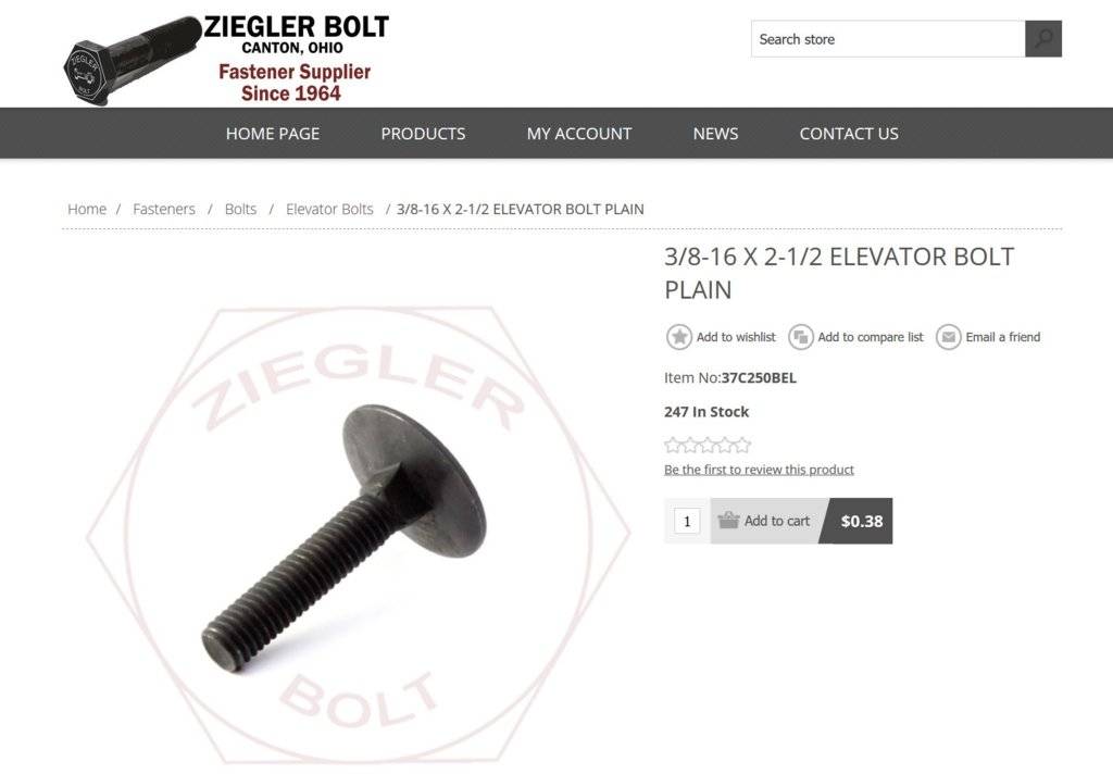

It looks cool, but despite their name, an elevator bolt is not a strong fastener. It's used for attaching the ends of conveyor belts [grain "elevator"], thus the big flat head to keep it from pulling through the soft belt material.

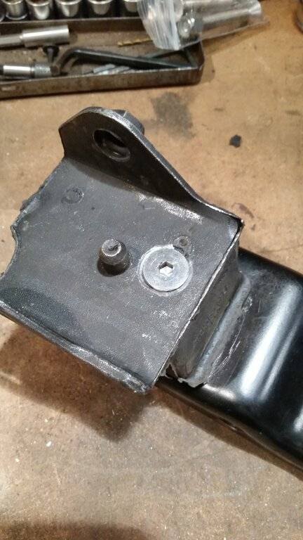

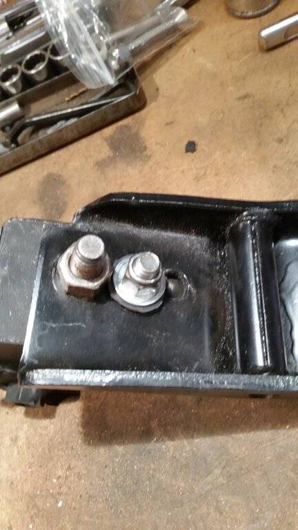

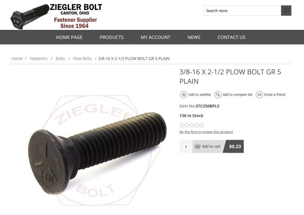

Interesting thing......the link I provided to the dodgecharger forum (it's working now, btw) had a similar discussion and worrying about what bolt to use, and this sort of thing is common in every car and motorcycle forum. But may I suggest that forum members simply get a Grade 8 hex bolt or two, grind the head down a bit, drill the mount, and permanently solve the broken motor mount problem? It's that simple.

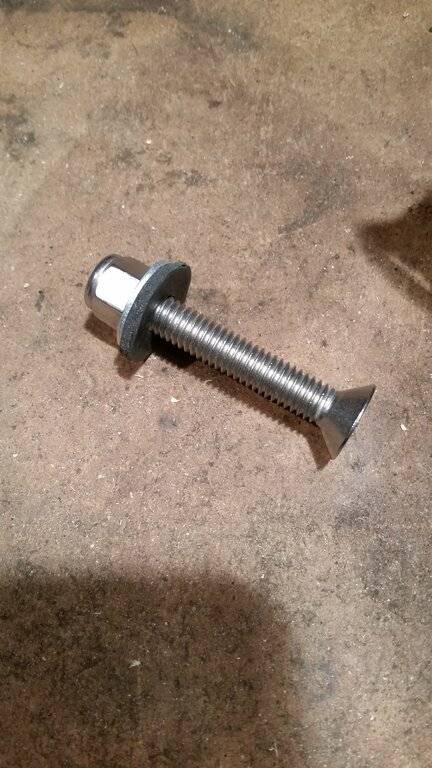

This is what I did (I used stainless fasteners). I also used a jam nut so I could leave a little slack in it to permit the mount to cushion the engine vibrations and not worry about the nut backing itself off. 2 or 3 years in, no issues, and I don't even notice the mod.

Nicely done. That mount will last forever. Literally!
And yes, you MUST leave some slack in the bolt/nut, using either a Nylok nut or Locktite Threadlocker so the mount can act as a vibration dampener. Otherwise, your teeth are going to vibrate. I set mine at about a sparkplug gap, but considering how much even a new OEM mount would allow an engine's driver's side to "rear up", 1/8th inch of slack would be perfectly okay.
