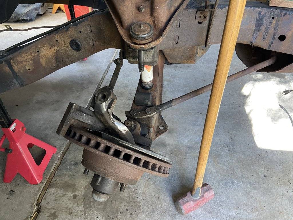

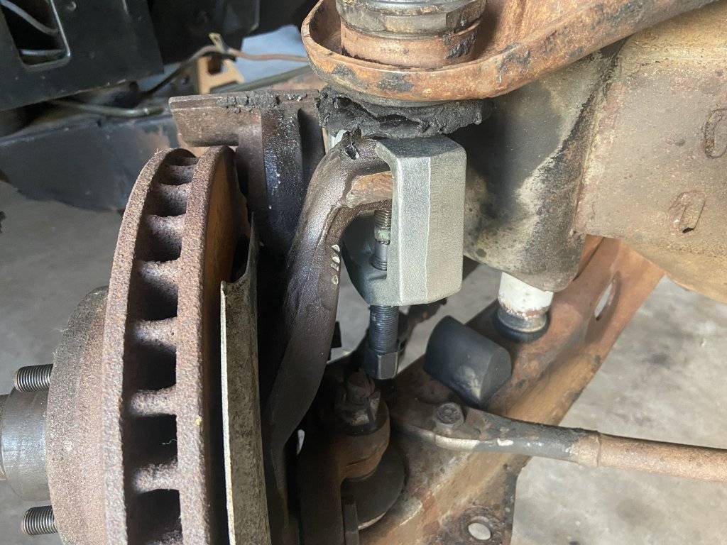

I have to remove the upper control arms to change the inner bushings. Not having much luck with the ball joint studs, the puller isn't cutting it. I've also tried an air hammer on the spindle while under tension from the puller, and whacking the side pods on the spindle with a hand sledge. Anyone know of any other tricks?

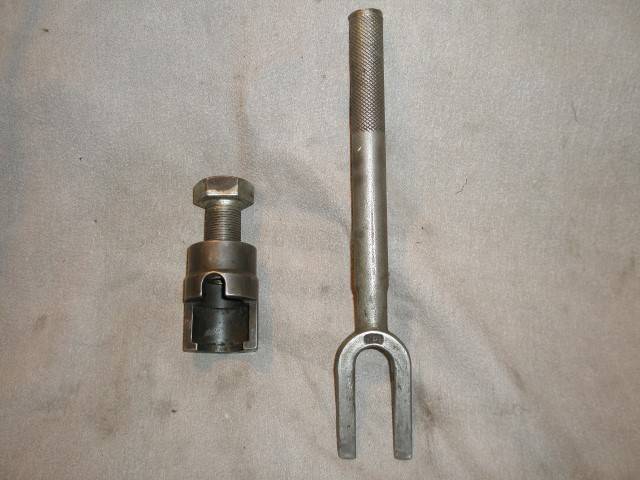

Try putting some penetrating oil on it, maybe that would help. The only times I've had to remove the upper ball joints I was replacing them. I didn't worry about damaging them. and got them out with a pickle fork.

Thanks for the suggestions guys. Lots of good ones here. For now, the right side is sitting there under tension, hoping it pops overnight - both sides are soaked in PB Blaster. I'll try the lever action puller tomorrow if I can find one big enough, these take the size large puller that is usually for pitman arms. Big cars, these. If that doesn't work, I'll pull out the nine pound sledge and hope my aim is true.

Looks like chisel marks on the side of the steering knuckle/spindle. I would not hit the knuckle any more.

Pickle fork and a big hammer: I needed room to create a big strike with the hammer. No short distance hammer swings.

something just short of a full roundhouse does it. not for the weak of heart. hitting the side of the knuckle actually distorts slightly the round hole that the tapered pin goes through. that's what pops it out. now imagine the force needed to do that. brutal but it works. a chisel is not to be used. it would be stuck directly with a hammer and when done right it never fails. if it is damaged already then use you best judgement.
The pic seems to show the nut removed from the stud. If this is the case and the stud "pops" out, the release of energy could be damaging. I would suggest you thread the nut about half way on the stud to prevent trouble. Just a thought.
Since the boot is already damaged, I would agree that the pickle fork is the best route. Lindsay
Success! The BFH did the trick. I was aware of this option, just hoping I wouldn't have to use it. As for the force required... I'm glad I go to the gym. I dressed the hammer marks down with a flap wheel to tidy things up and to reduce the possibility of stress risers, like what you would do with a gouged torsion bar. The ball joints are all in great shape, so I didn't want to ruin them with a pickle fork. I will replace the rubber boots on the uppers, lowers are still mint.

Absolutely right. If the torsion bars were still installed, I would have done just that.

Those were hammer marks from the hand sledge. All smoothed out now.

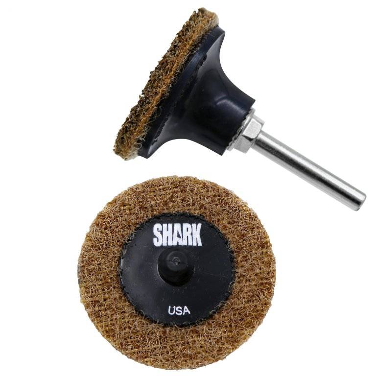

for smoothing out any metal i use a cookie wheel such as shown. they're supposed to be used for gasket removal but i won't use them for that because they remove metal and can affect a seal surface. found that i could sharpen drill bits with them.
