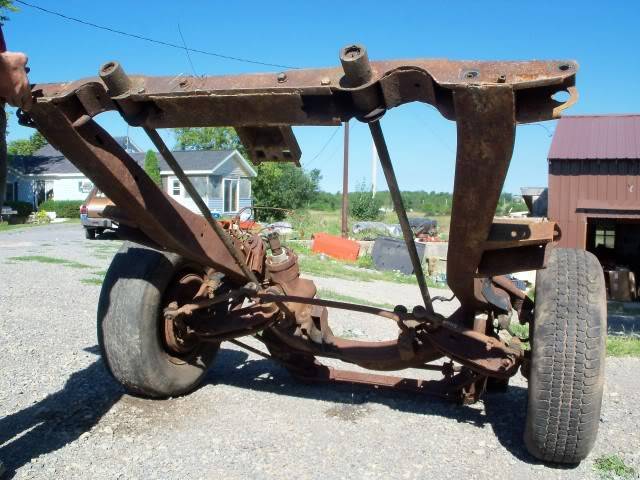

Maybe a visual will help describe what's going on...
When you remove the crossmember, you are removing the connection between the left side and the right side.
When that happens, the Torsion Bars "twist" the unconnected ends downward.
