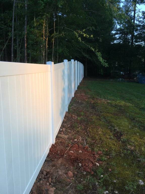

That is NOT how to erect a fence.
Cheap low bidder bastard.
Correcto! do I smell Pedro here?

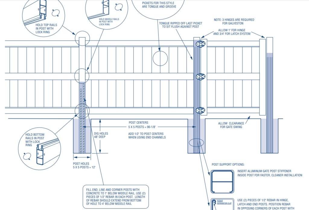

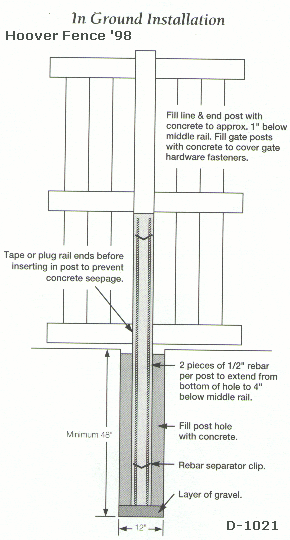

Heh and more here:
I can guarantee they skipped the "Concrete must be mixed prior to pouring in hole." part. (It's the Southern way) :p

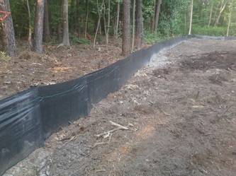

Oh and they forgot this fence (better call the EPA)

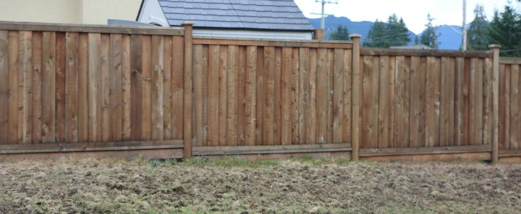

If not possible to as said above:
View attachment 305109 View attachment 305110
Stan has shown some nice fences, but it's a selling feature that the cheap vinyl fence is rackable... In my neighborhood, if part of the panel exceeds 6', you have to go downtown and beg for a variance... or rebuild the fence. Makes that pretty stepped fence either less than 6' or begging and pleading required.
I'm in doubt that Bob has the same level of stupidity as I have... but the fence company just tosses this crap together with the cheapest labor they can find... it should hold up for their labor warranty period and I don't hear of many successful warranty claims on the vinyl.
I believe this is a prefabbed fence. I was looking at it as they were building it. There are slots made into the plastic for it to fit together. Don’t know if there was a way to level it. I agree though the level/staggered look is better. Not my dime so unless who ever buys the lots on the other side complains then I guess that’s how it will be
Folks around here like to follow the ground contours so they can get the full 6'... the worst sin is they anchored it mostly into that berm they built... easy digging, but a weak foundation.
Yea I was thinking the same thing. That berm could was away in the next hurricane & take the fence with it

..., if part of the panel exceeds 6', you have to go downtown and beg for a variance... or rebuild the fence. Makes that pretty stepped fence either less than 6' or begging and pleading required.
You are not alone in that respect. The upside in this installation is that it is the equivalent of an 8' fence because of the berm.

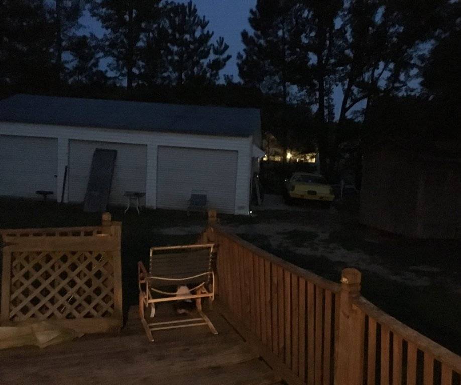

View attachment 317065 They got the lights going on one of the houses behind me. Basically in my back yard. I’ve noticed that every time they get the lights working they leave them on all night untill the House is sold. So I get to see this. They will eventually be houses all around me as they have gone to town. It’s a friggin shame is what it is.
Now would be a good time to bury a wire and get the shop some free power... :lol:
